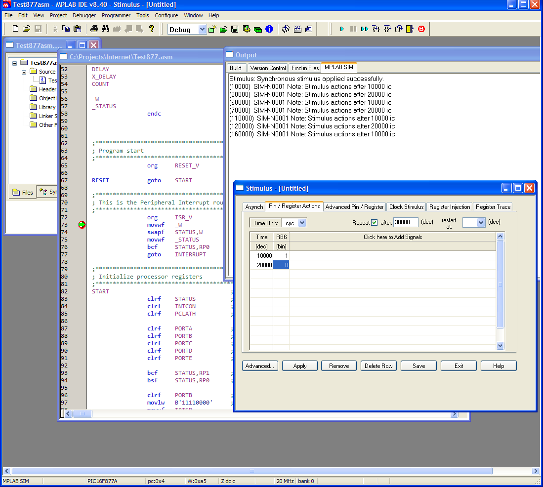

Hi all,
I am learning asembler. I am working with Microchip's PIC microcontrollers in particluar PIC16F877A.
My issue is that I have a program and using MSLIM. The program is simple however I cannot seem to get the stimulus to work. I wanted RD4 to go high but when I set the stimulus it does nothing.
The program is below.
The program just follows an indefinite loop until an interupt... but I cant seem to get stimulus to cause an interupt of infact to work...
Here is a video screen capture of it not working...
Hope you can help..
Simon

Just tried your code and it appears to work fine. Maybe you are setting up the stimulus wrong. See attached for how I set it up.
Edit, BTW if you type
 before your code and
after it then it will keep its formatting.
I assume by using the stimulus you are applying a logic level to an input and wanting the code to respond. If this is the case...
It looks like your code:
MOVLW B'00000000' ; RD0-3 as outputs RD4-7 inputs
MOVWF TRISD
is setting PORTD to all outputs. Therefore it will not respond to an input. Change the above to
MOVLW B'11110000' ; RD0-3 as outputs RD4-7 inputs
MOVWF TRISD
and it should work
Bill
