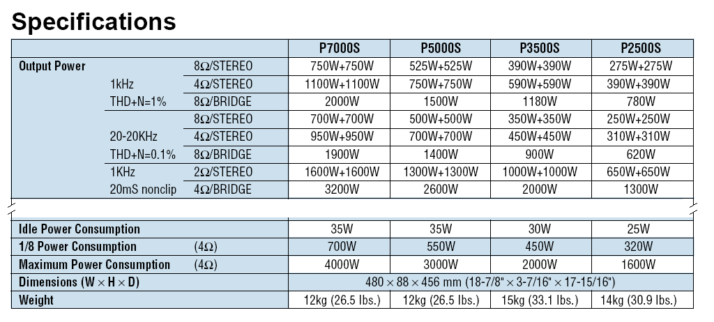

Reading this reply and looking at the photograph, has made me suspect that this might be a class D amplifier. I can't see and huge heatsinks, those inductors look pretty huge and 81% efficiency is too high for it to be class B or AB.
Well it's got large fan cooled heatsinks, so it might be a class AB amp?, and there doesn't seem much in the way of low-pass filtering on the outputs if it's class-D?. I'm not sure what the two low inductance toroids are doing at the bottom, but they aren't near the speaker outputs.
I think I made a mistake calculating the efficiency, perhaps it isn't class D after all.
Here was the page I mis-calculated the efficiency from, as you can see, it is a bit confusing.
