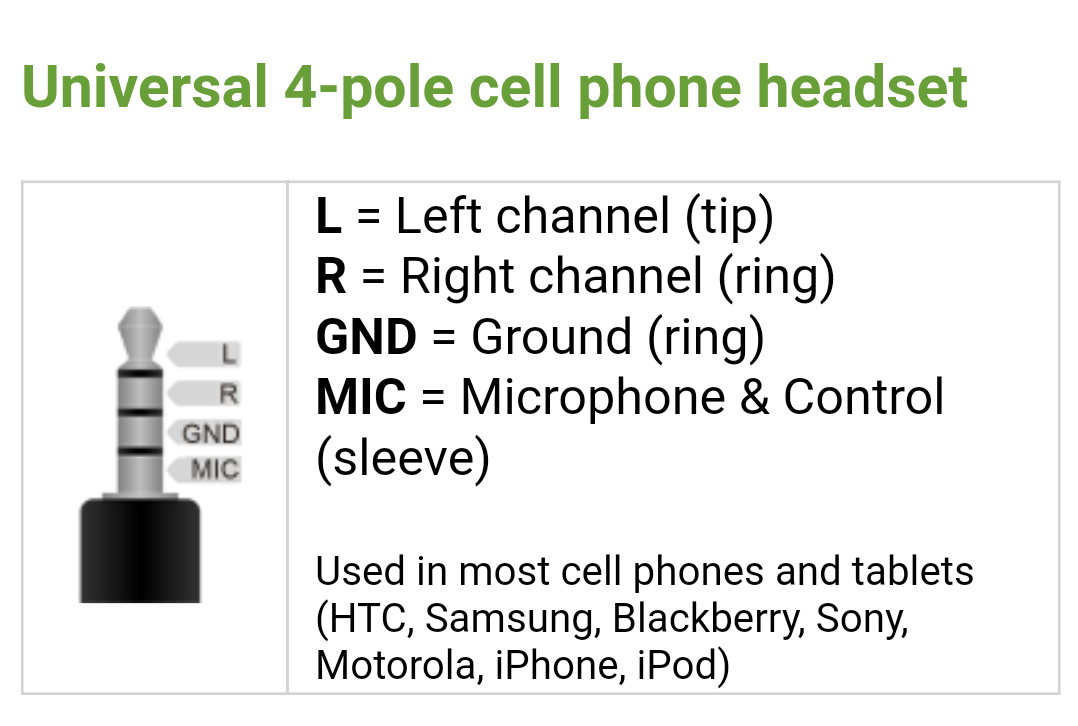

i am looking for TRRS audio jack female connector. one that supports both microphone and headphone connection. Is this part https://www.cui.com/product/components/connectors/audio/3.5-mm-jacks/sj2-35364b-smt-tr such a connector?
how to know which is TRRS audio connector with microphone and headphone support?
