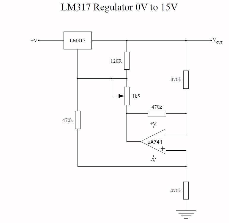

Hi Guys
I need a PSU that goes from 0-5v.
It needs to go down to 0v, well, 0.5v I could get away with as the equipment I need to test needs 0.6v for the first test to kick in.
I've been trying the attached circuit but can't get it to go below just over 3v.
Any ideas?
Cheers

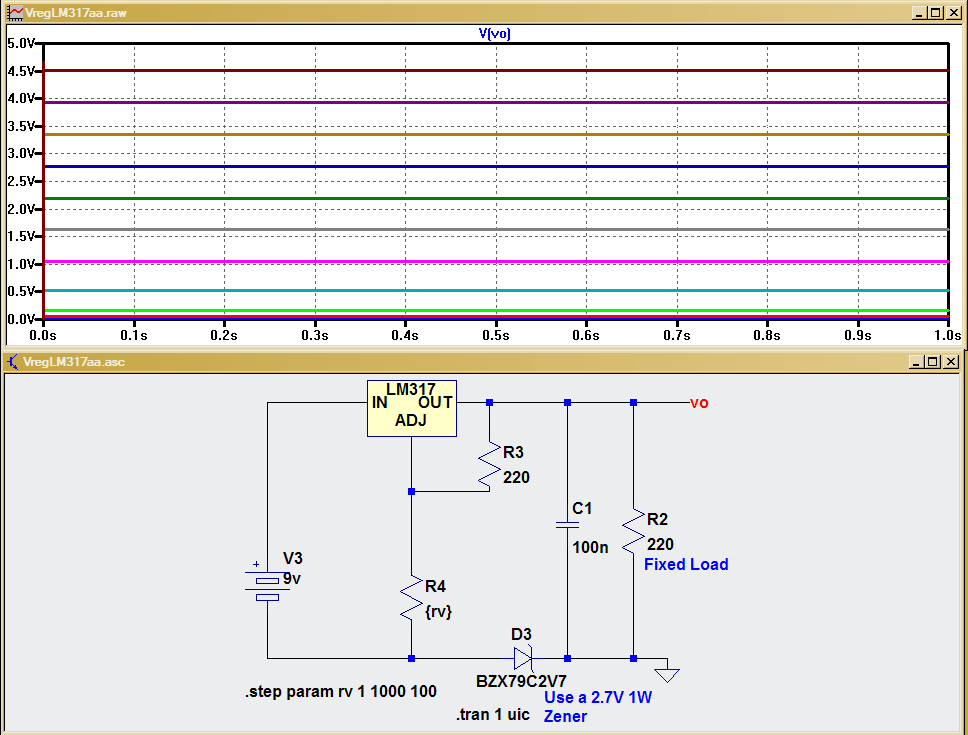

What I have seen are supplies which have a low voltage zener or 2 or 3 diodes in series at the 0V input end of the supply.
These give about 1.4V thru 2.1V drop along the 0V line, the ADJ of the LM317 is connected to input side of the diodes/zener, so the output of the supply is ~0V thru +V.
I will try to find the circuit.
This is a simple way to get close to 0V output.
The regulation is not as good as a direct connection LM317, bit does enable a close to 0V out.
Choose a 1Watt zener also the 220R fixed resistor is required.

The zener in the return current path will give poor load regulation. The circuit in the app note uses an extra rail (negative rail) & allows the zener reference to pass a steady current & therefore has better load regulation.

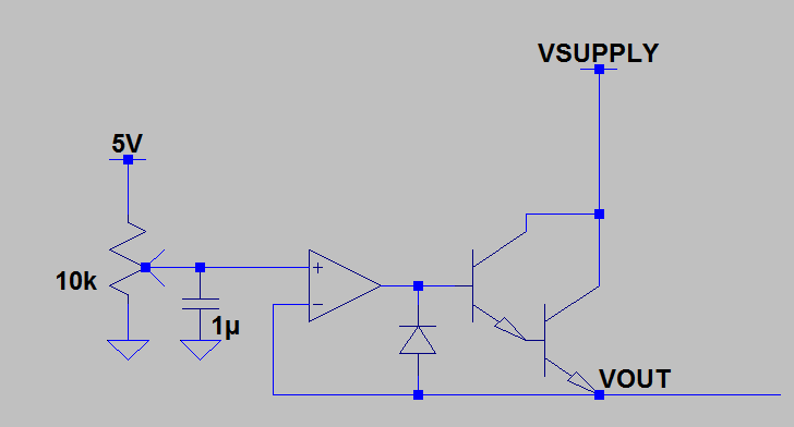

Another way of achieving the 0-5V output is using the attached circuit. The opamp inputs and output must be able to operate close to 0V. A 5V regulator can supply the 5V reference.

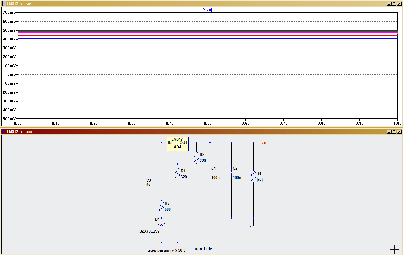

The LM317 datasheet shows a way to use a second LM317 in the negative rail to act like a fixed 1.25v zener, to give full adjustment down to zero volts.
Personally I like the opamp approach.

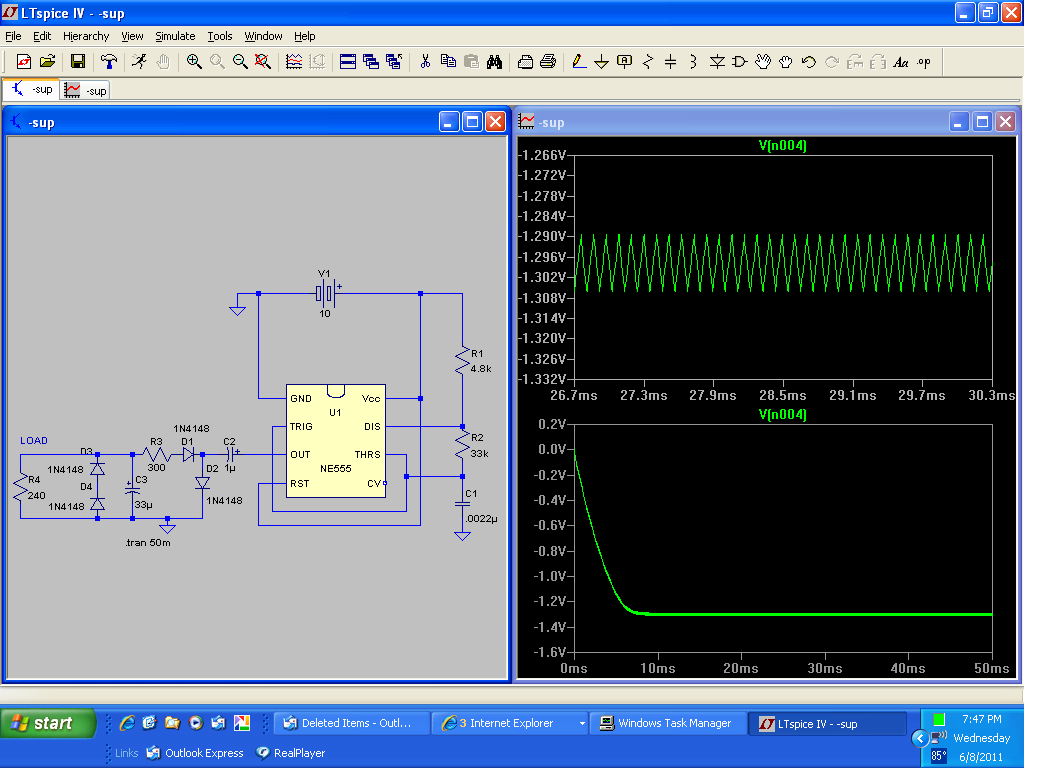

Negitive Supply
Here is a cheap & dirty negitive bias supply.

With a single voltage source the LM317 can be configured to give an output voltage of ~1.25/1.5V
Try some of the ideas suggested in order to get 0V
EDIT:
NOTE: in your original circuit the 741 is powered by positive and negative voltage, thats how the 0V out is possible.
Powered by a PP3 9v battery....I built the original cct using the diagram at the begining of the post, but couldn't get the o/p below about 3v.
It needs a negative supply for the opamp. Otherwise the output voltage is going to be the 1.25V of the LM317 added to the minimum output voltage of the opamp (which I guess is 1.75V in your case).
