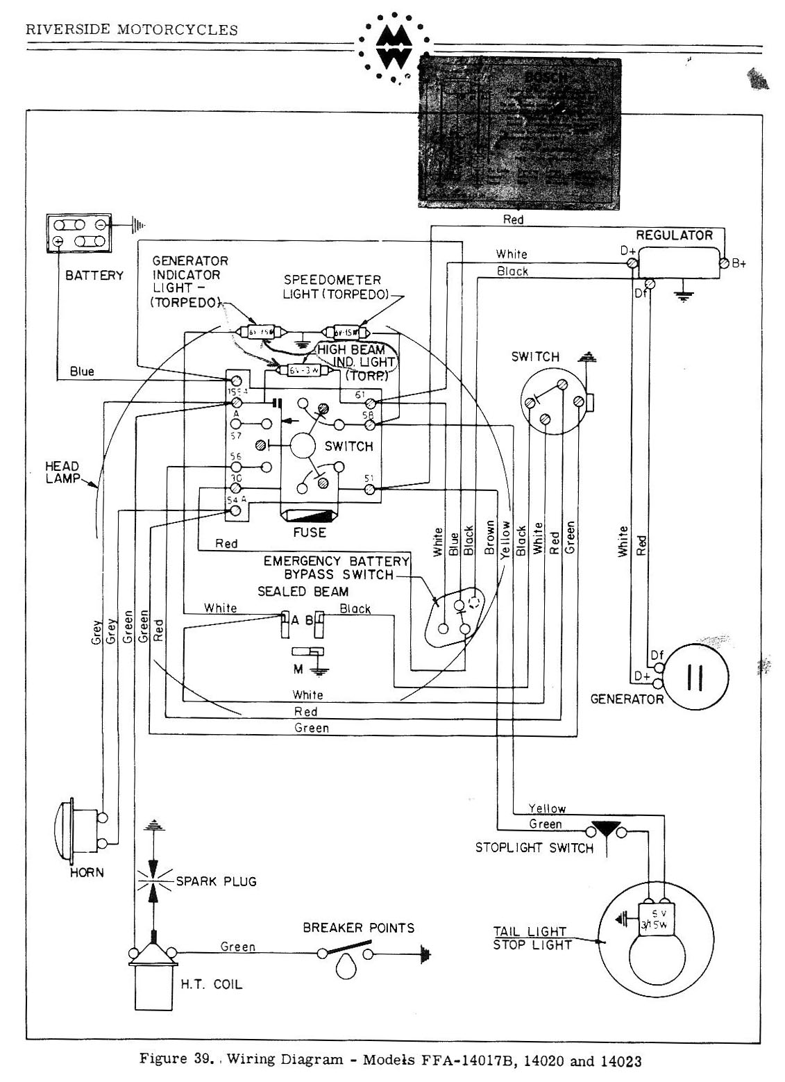

Although titled as a 1969, the motorcycle was likely made in 1965. It has a flywheel mounted generator, and a rectifier, providing 6v DC current. Because it's flywheel mounted, the generator turns at engine speed, so at idle the system is consuming more power than it's creating. The battery size is limited by it's position in the frame, and is on the small side. The whole system is marginal, but this was common w motorcycles of that era, although they were soon replaced w better systems when electric starting became the norm.
Improving the charging would entail a complete gutting and replacement w a modern system. Part of the charm of an antique bike is running as much original equipment as possible, so I'd rather try to keep as close to original design as possible. Attached is the wire diagram, and original pages on generator repair.
I'm open to ideas.

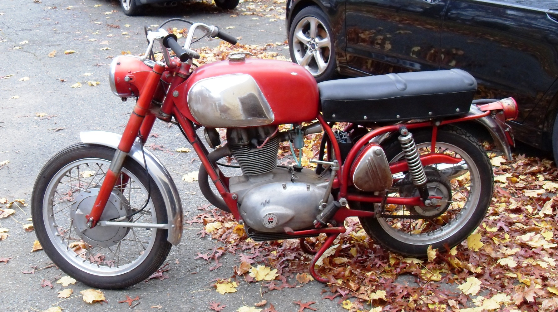

The blue Sears/Gilera was in definite need of a voltage regulator (wasn't given one by the factory), so that was an easier fix. The Benelli/Wards bike (photo attached) doesn't have a single obvious problem. The issue is more like a number of weak design flaws, so it's not clear what can be done.
But I'm no electrical guy, which is why I'm reaching out to this board.

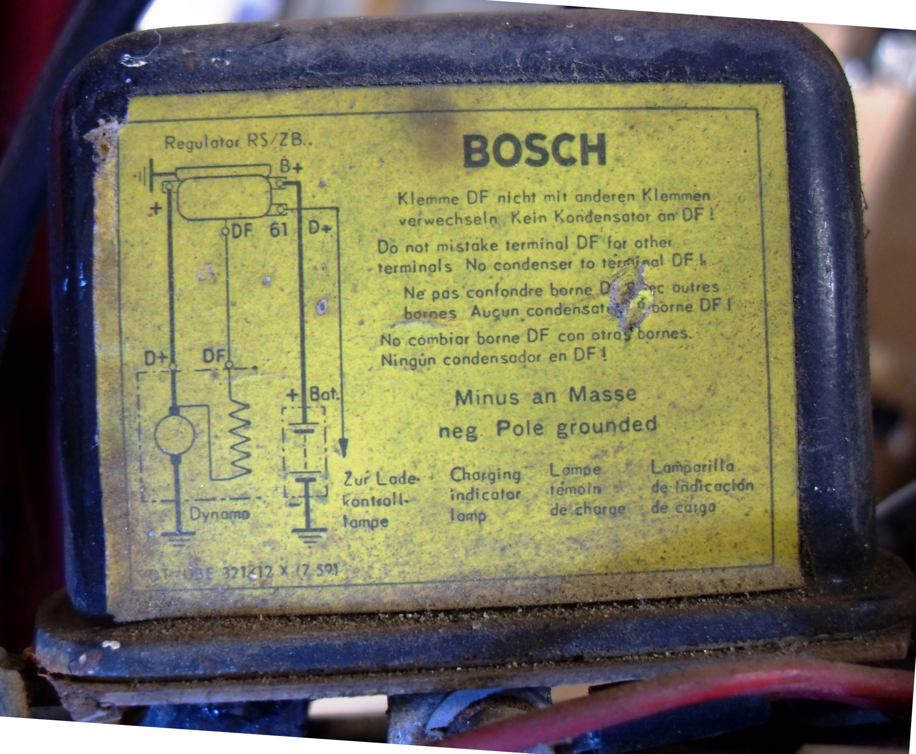

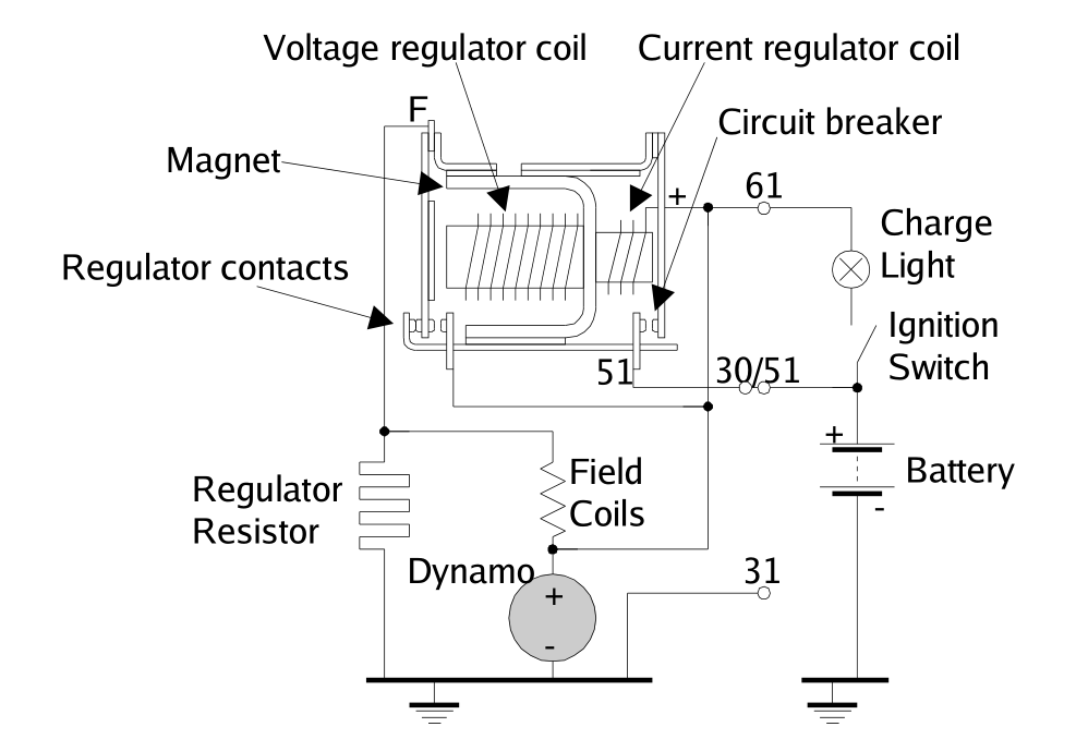

It's got a Bosch mechanical voltage regulator (see attached). It's possible that the crude circuit is eating batteries. How can I improve it?
Joe

I don't think you can, the basic premise is rubbish to start with, there's not enough power from the generator.
My last bike was a Yamaha DT400 trail bike, and that had crap electrics as well - I was never able to come up with any idea to improve it, converting to 12V would obviously have helped, but it wouldn't improve the power from the alternator.
Is it possible that the mechanical regulator is a drag on the system? It's operation might be crude, and eating up power. A modern regulator could pass on more energy.
It would probably lose a little less, as long as it's well designed, but I doubt it would be enough to solve your issues.
Replacing as many bulbs as possible with LED's would greatly reduce the strain on the electrical system (rear light, brake light, indicators), is the headlight powered by the battery, or direct from the engine?.
As long as its in good condition it should not be a problem.
However - it's a dynamo system, the dynamo has brushes and a commutator, which wear.
Make sure the brushes are free and plenty of length on them, the com is clean and if there are grooves between com segments, give them a scrape with the tip of a wood toothpick or similar, something that can remove any carbon build-up without damaging the copper.
It looks like replacement brushes are readily available for old 6V bike dynamos.
