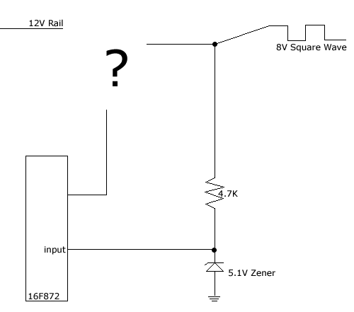

I'm using a pic to read in a square wave at 8V... To do this I'm running though a resistor and then spliting to my pic and a zener diode connected to ground. End result is that my pic can see 0V and 4.5V for the high of the wave.
Now I've decieded I want to also transimit on the wire the wave is coming in on. I plan to wait for a long silence and then begin transmitting via turning the pin high and low, creating my own wave on the wire I already have coming in.
My problem is I have no idea how to send 5V out of the pic and have it go into a transistor of some sorts, and then have an 8V signal get into the square wave wire.
A problem I see is that I believe I will be cutting my own signal down with my resistor/zener setup that I need to read the signal in.
Ideas ?

First thing, you don't need the zener diode, the PIC inputs have clipping diodes to supply and ground - so you simply need a series resistor, personally I'd use a higher value resistor though.
Transmitting on the same wire depends on how it's connected elsewhere, as long as it's connected via open-collector drivers with a pull-up resistor you could easily do it with a single NPN transistor and one resistor.
If it's not done in that way it might not be possible, you really need to post the circuit diagram for the other end. You also, obviously, need to implement a suitable protocol for the communication - at both ends.
Also, 8V is a strange level, how come?. This is what worries me about making the link two way!, I suspect the other end isn't built by you, and you don't have design access to it?.

Are you sure about the not needing a diode? I can see that the voltage is 4.5-5 at the pin, I'de be a little worried just letting 8V into it and assuming that its just going to be ok.

Yes, the internal protection diodes are there for that exact purpose, all you need is a current limiting resistor - try looking at the input pin diagrams in the datasheet. The input pin can't go above 5.7V or below -0.7V, the internal diodes clamp it to the supply rails - unless you feed it too much current and blow the inputs, the resistor limits the current keeping it safe.

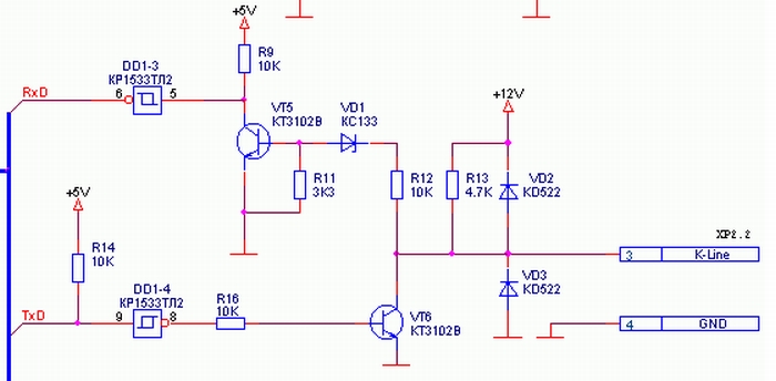

For your circuit (it uses PIC) I would recommend simple interface
like in the K-Line of following drawing. I'm no expert in Russian
language but you should be able to copy two transistor circuit
up to schmidt trigger inverters and substitute those components
with parts you keep in your drawer.
http://www.radioland.net.ua/images/Avto/auto_comp1.gif
Btw. the K-line is normally high (+8 to 12V). It is pulled low
by transmitting node. L-line is only used for initialization and
most systems don't use it (I've not seen one yet to be honest).
The inverters KR1533TL2 are same as 74ALS14 according to chipdir.
Zener diode KS133 is supposedly 3.3V.
Transistors KT3102V are equivalent of BC546B,C; BC547B,C
and also replace the KD522 diodes with 1N4148 for example.
Hope this helps.

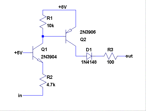

I just want to send 5V out to somthing and have it allow 8V to get onto the bus line. I cant any (understandable) transistor configurations to work

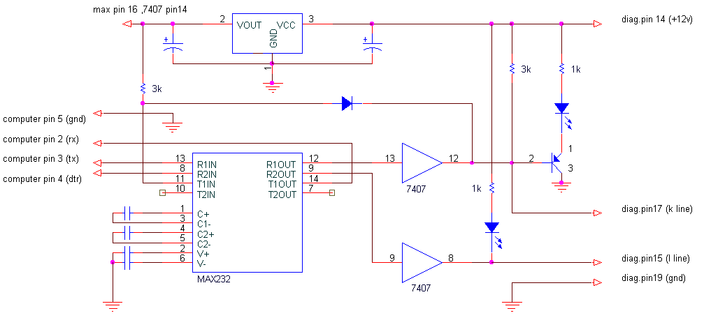

It looks to me you have to sort out what interface you need. Anyway, here is the circuit we used as reference

Why don't you do as in fig.5 of the ELM322 datasheet? See below for a schematic of the relevant circuit. Keep in mind that this inverts. If you want it to be non-inverting, you can change Q1 from common base to common emitter, although that would seem unnecessary if you are driving from a PIC.
Ron H:
The more I look at that one the more sense it makes (almost).... at first I didnt like the idea of it inverting, but really, all that is going to mean to me is that when I want to send a high on the line, I ground my pin and when I want a low I float it ?

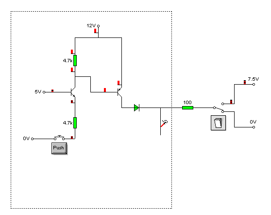

One question though. In my setup I have very easy access to a buffered (not direct to battery) 12V. I'm curious as why my simulation says that no matter what voltage I put instead of 8, lets say anywhere from 9 to 20V the output is always close to 7.66V ? (Which is PERFECT, I'm just wondering why)
I know someone is going to tell me ohms law bla bla bla and not explain it so if you are reading this and plan to say "Cause of Ohms Law" and not explain yourself, please try and refrain. :D
Actually, it's due to Murphy's law. :D
Seriously, your results make no sense. Can you post the complete schematic that is giving you those results?
To get a low output, you could float the input or pull it high actively. I think that if you want to float it (open collector or open drain drive), then you should add a 10k resistor from the emitter of Q1 to +5V (preferred), or from the input to +5V. It will probably work without the resistor added, but it will switch more rapidly and cleanly with it.
I know it doesn't make any sense, but its what Crocodile Clips is telling me... (I like the funny sounds and pictures for the symbols... and oh man, that crocodile that eats broken components, ha don't even get me started on that crazy crocodile)
Anyway, I can enter in 9-20V where I now have 12V and the voltage on the probe stays the same... This all only happends when I press the PUSH button o/c
The STDP switch is to pretend the other nodes changing the wave from 0 to 7.5.
I figured that it might be possible because of the emitter follwing the somthing else or somthing like that (that I never really understood)
I posted the diagram, let me know,
