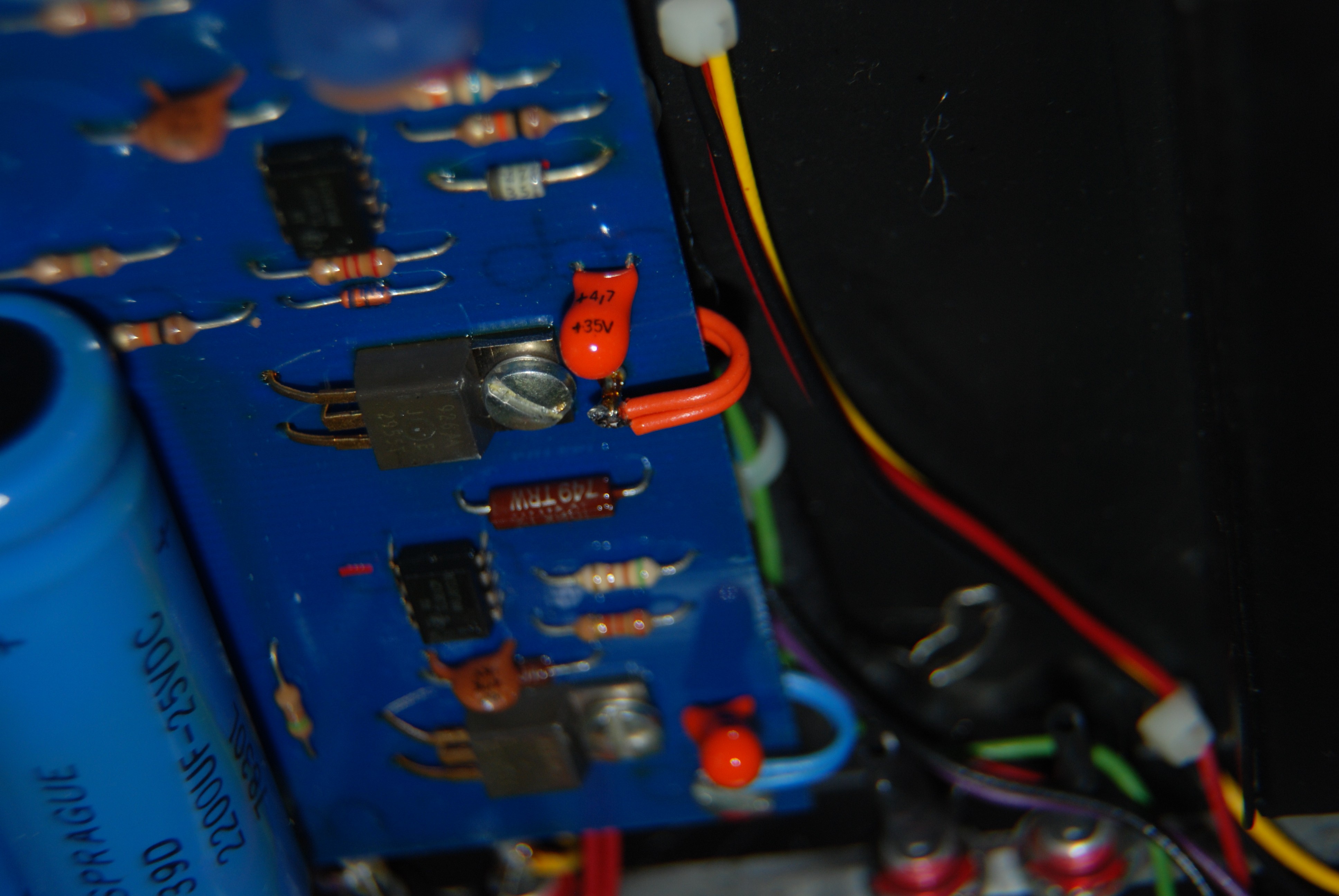

Trying to decipher a particular capacitor rating
cherylk
It's an orange drop cap.
It has +4l7 +35V on it but the 4l7 looks like:
+4 7
l
I can't tell if it is a numeral one, a capital "I", or a lower case "L" and it is written like a subscript.
Can anyone help me decipher this? It is in a 1979 vintage pre-amp.
EDIT: I can't make this look right. The edit function keeps dropping my spaces.
The "l" is a subscript between the 4 and 7.
.... The "l" is a subscript between the 4 and 7.
I think the "l" is supposed to be a comma ( , ) and is used as a decimal point.
I have seen capacitors like this before, I even have some somewhere.
So your capacitor is a 4.7µF
Take a picture of it and post it, it'll replace a thousand words =)

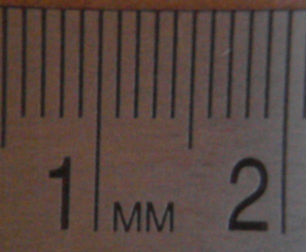

Attached is an image I just shot sitting at my desk using my cell phones12-14 inch fixed focused lense in bad lighting using a flashlight and a piece of paper as a diffuser at 1 inch from the mm scale of my ruler using a cheap Chinese 10x plastic eyeloop to adjust the focus, all freehand. Based on some rough guesstimates and the general focus quality of the image it allows for seeing details down to about .2mm

I've been bored a few times, I've done the same thing using a pair of binoculars as a telephoto lens for some birds shots. Not great, not bad, more than clear enough to view.
Fixed focus is easy to deal with, and a lot of modern digital cameras use a through the lens auto-focus technique which will automatically adapt to any additional lens put in it's way obviously within it's ability to focus, you lose the edges of the images, but even old digital cameras have enough usable pixels to spare.
I've got a desk magnifier lamp that I've used with an old digicam (KODAK DC3200) to get "almost macro" shots. I just clean the lens real well on the lamp, then focus thru the lens (via the CCD preview) as best as I can. The nice thing is the lamp give even lighting to whatever I am photographing. Its nothing compared to my small Canon with its macro/autofocus modes, but not bad for the cheapness of it, either...

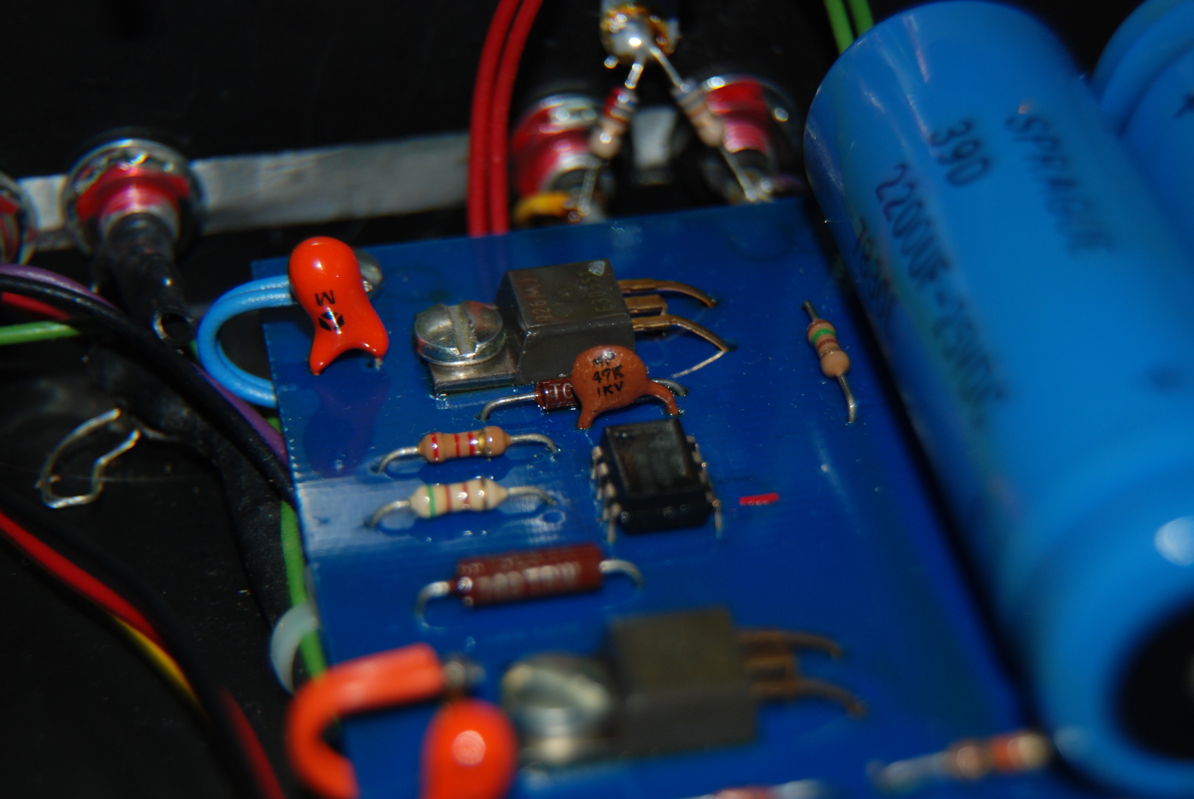

Okay, finally. Let's see if I did this right...
There is the weird orange drop cap. It's a little hard to see because of the angle. I was afraid if I bent it down further it would break.
In the other picture is a ceramic cap that has "47K" on it. I think it is 47pf with a 10% tolerance. Someone else told me it was 47,000pf. And yet another person said both of those are wrong and it is 470,000pf. I'm pretty certain the last one is dead wrong.
What do you guys think?

Cool! Thanks JimB. I've been trying to read up on all of this coding.
Interesting that I was the only one who actually got the ceramic value correct. A guy at Mouser electronics was the one who said it was 470,000pf and told me they had nothing like that in stock. :-(
I didn't know they were making tantalum caps in the late 70's. Do you know if they go bad as often as the other orange film caps (mylar and PP)?
Thanks! Cheryl

One more question: How can I tell which lead is positive/negative on the tantalum cap whose picture I posted earlier?
The only possible markings I see are the + signs in front of the +4.7 and the +35V. If those are the polarity markings, then it looks like the left lead is the positive. Is this correct? HELP! Or is it some type of special code?
My new one is fairly well marked and I looked up the spec sheet to be sure and it has the positive lead on the right.
In both cases, I'm looking at the side with the printing on it.
