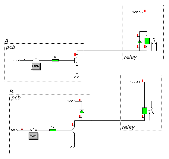

Hi... I have automotive circuit using a pic that when certain input are given drives a transitor high that then in turn connects the coil of my relay, triggering it.
I know that in order to protect the transistor from emf backfeed I need to and have been using a relay with a diode across the coil. I'm using some green ones from delcity but would MUCH rather use a normal diode that I can find at any autoparts store incase I have a problem somewhere down the line. A reliability issue. Plus these things are expensive!
So... I was wondering since I'm using a the same voltage souce (12 battery) for everything, is it possible to move my diode onto my board and still have it provide the same protection ?
My current circuit is A. and the one I would rather be using is B... The sim says that this will work just fine. But they are not always right so....
Any Suggestions ?
Thanks!
Looks fine. Protection diodes are usually put on the board rather than included on the relay itself.

Just be careful when design the PCB: this line (track from collector to relay) radiated more noise when the relay switch off.
Method B is how I do it.
I use standard Bosch relays, and I also use some cheap PCB mounted automotive relays I got from Digikey of all places. Cheap and Digikey, don't usually mix.
From the point of view of protecting the transistor from the back-EMF from the relay coil, solution B is probably as good as solution A.
But, if there are other circuits nearby which are sensitive to magnetic fields, use solution A.
The problem with B is that you have a large loop of wire, from the relay to the diode, from the diode to the supply, from the supply to the relay. When you de-energise the relay, a large current pulse will flow in this loop and create a varying magnetic field which will induce voltage spikes into other nearby wiring.
Not entirely correct. Solution B has the advantage that the free-wheel diode is as close to the switching device as possible. This reduces and stray inductance between the diode anode and the switches positive terminal.
If solution A is used and teh layout is very bad, this stay will cause turn-off voltage overshoot's higher than would have occured in Solution B. This will increase turn-off switching losses as well as potentially causing reverse voltage breakdown IF the deive is chosen to have a low peak voltage (say 20V), you can seasily see alot more that that

De-energizing the relay does not cause a large current spike. The current that was flowing through the relay when it was energized simply looks for another path, because it can't stop flowing instantaneously.
Actually, in B the current in the wire to the relay will decay relatively slowly when the transistor is turned off, while in A the di/dt in that wire will be much higher, causing a voltage spike v=L(wire)*di/dt, which is what Styx was alluding to. The EMI from A will be worse than that from B. When the transistor turns on, di/dt will be about the same in both cases.

Yup, just re-read my post and it is quite broken.
Basically with power-electronics you need to keep stray inductance to a minimum
With B there will be some stray inductance between the inductive load and the diode-FET but this just adds to the load inductance and is find.

Styx, I thought your post was fine. I was just commenting on JimB's post.

Oh, I mentioned this is an auto circuit but I was wondering. Even thought the 12V is coming from one source. The 12V I have coming into my pcb is an ignition feed and not direct to the battery... Does this matter ?? (Also, I think I know the answer to this, but would this work if there were 2 batteries (two different 12Vs?))
