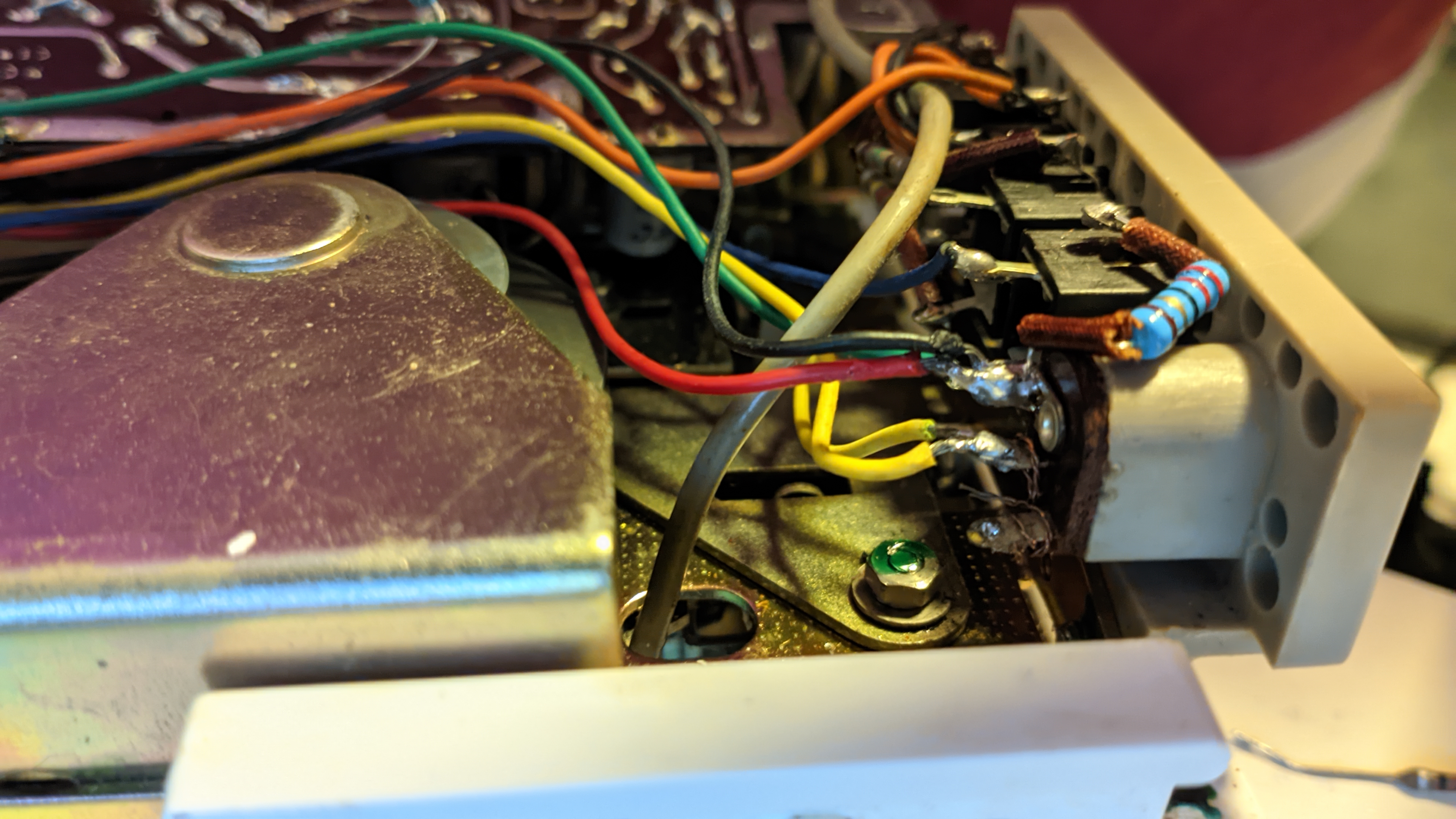

I've been trying to fix this old tape recorder in the past couple of days. I have basic knowledge on electronics, still trying to learn. The tape recorder doesn't play any audio, everything else works fine (mechanically speaking). Tested most capacitors and resistors, all of them were fine (except one), no short on the circuit. Speaker is working. No sound on EAR output too.
I narrowed the problem to somewhere around the two 2SB324 transistors (Q4 and Q5), the 2Ω R20 resistor connecting the transistor emitters was visually burnt from overheat, still working, but with higher impedance (13Ω). Replaced the resistor. Reading the voltages on the Q4/Q5 transistors pins I got:
E: slowly increasing from 0.8 volts
C: slowly dropping from 5.4 volts
B: slowly dropping from 5.25 volts
Both transistors are running really hot, to the point of burning the solid/liquid thing around them, inside the heat sink, in less than a minute running (heats faster with a cassette tape on). The resistor I replaced is also burning, probably due to the high current going into it.
Base from transistor Q3 is running at 5 volts instead of 0.8, all components around it are working as intended. Q1 and Q2 are running fine voltage wise. Don't know if it could be the transformers or transistors at fault. I'm stuck here. Don't know where to go from here

The only modification I've made is the resistor swap, all other cables are from factory (presumably)

OK, you don't repair things by randomly trying to test resistors and capacitors - the VAST likelihood is transistor failures, particularly in the output transistors, which then caused the emitter resistor to burn up. Just replacing burnt up resistors is highly unlikely to cure anything, you need to repair the cause of the resistor burning up.
You're also fairly vague on your voltage measurements, you don't mention where you're referencing them from?, or what polarity they are?. This is an antique design, and thus uses a positive chassis - all voltage readings are negative, with respect to the positive side of the battery (chassis).
As it's a transformer coupled amplifier, there's no DC connection (as with more modern designs), so all that will have failed is likely to be the two output transistors, and the damaged 20 ohm resistor.
I'm presuming the batteries are connected the correct way?, pin 5 of the output transformer should be positive, and all voltage readings (made with the black negative probe) should be made in respect to that. The negative of the battery should be connected to pin 2 of the output transformer.
