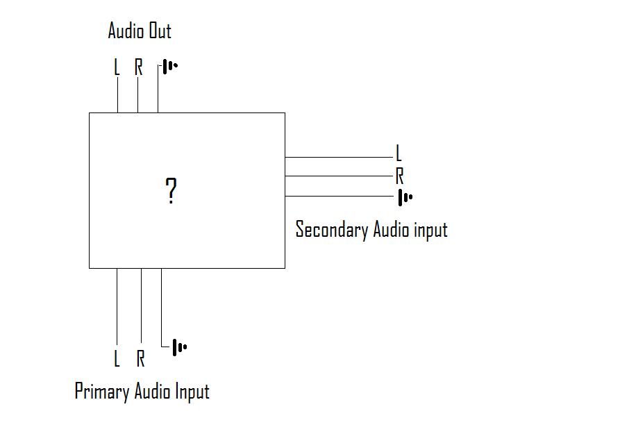

Noob here, trying to make a circuit (or find one)
I'm trying to take a radio, and add in an auxiliary port.
This is easy by tapping into the FM tuner's L & R audio output. But, I want to leave the FM functioning, still easy to do with a standard 3.5mm stereo jack, that switches when something is inserted.
But I don't want to use a headphone jack, I want to use RCA's
Any ides on an automatic (stereo) audio switching circuit?
That will switch over to the secondary input once it detects audio?
It's a 12v radio, and the am/fm tuner is pre-amp, so when I connect my mp3 player to it, it'll be a stronger signal of course, but I'll worry about limiting that later.
So, any ideas?

So when whatever is activated, and sound/signal is delivered to the RCA's it'll switch over to use the RCA's for sound. Thus, cutting off the FM/CD signal.

One option I have heard about is an audio level detector and a solid circuit relay.
Thoughts on that?

When it stops detecting sound.
I was thinking of this circuit:
https://www.electro-tech-online.com/custompdfs/2011/01/AUDIODETECT1.pdf
Combined with a DPDT relay

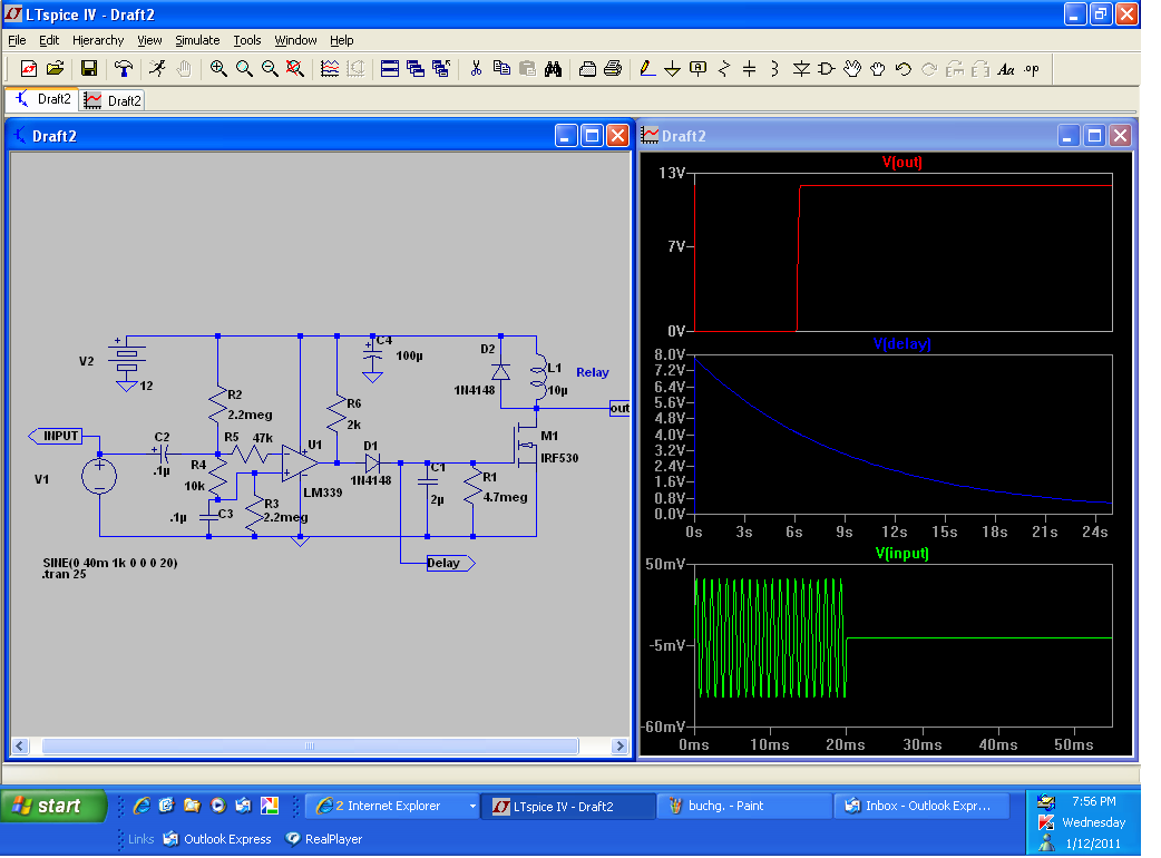

I whipped this up:
Whatcha think?
Questions are, the circuit is made to run off 3v, the radio is 12-14v, and the mp3/In is .03(?)v
Is it ok for everything to share the same ground?
Is it possible to convert the supplied circuit to 12v? the LMC7215 says 2v-8v, is there a 12v option?
Also, looks like the LMC is only surface mount. That is pretty small for me to try and solder down. Think there is a larger version? (with pins)

Try this one. It has about a 6 second delay before it switches back and runs off of 12 volts.

Ok, my expertise is quite limited. Really limited. I got the workings of a relay down, and that is about it.
The data sheet from mouser says the LM339 is a 16pin?
the IRF530 looks like this?
Surface mount hmmm? I guess I should tackle how I'm going to get that all squared away.
How does one connect that middle pin?
