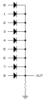

Another (kinda neat) way which could work is to basically make a "diode-OR" gate. Get 9 diodes (cheap ones, 1N4148, etc.). Connect the anode of each diode to the outputs 0-8, then connect all the cathodes together. Connect a resistor (4.7K or so) to ground from all those cathodes. Connect the cathodes/resistor to the input of your coupling capacitor. This way, when any of the outputs 0-8 are high, the output of this circuit will be high. When the counter rolls over to output 9, the output will be pulled low by the resistor. This is a "passive" circuit, no power req'd. (see drawing below).
JB
