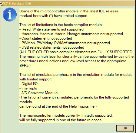

hi gra'
If you post your full program listing [ as a post attachment] I will run it in my system, see if I can locate the problem.
E
EDIT:
Please confirm the PIC type, the IDE says a 16F1459 does not have USB support.??

I saw that also but I thought it was a typo as it lists all of the chips with an asterisk. I am using PIC16 Simulator with basic and a few other options. On the web, the creator is listing a sample USB code for the 16f1459 chip.

I see why you have been forced to use Serin, its because Oshonsoft does not support the hardware UART.
I have come to the conclusion that the supposed upgrades to the Oshonsoft PIC list are a load of hooey.!:mad:
Over the past 12 months I have run into problem after problem with other later PIC's that do not have support for this or that feature.:banghead:
All my debug reports regarding the shortcomings of this IDE, except for one, have been ignored, I was advised to fix a compiler problem by adding more decoupling caps.!!
