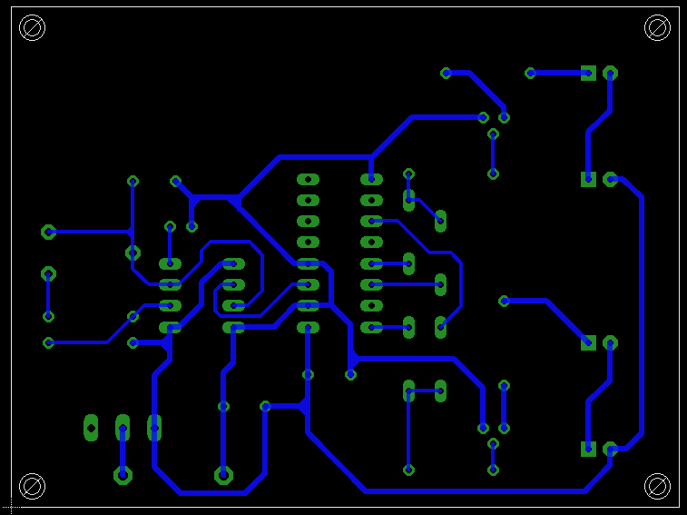

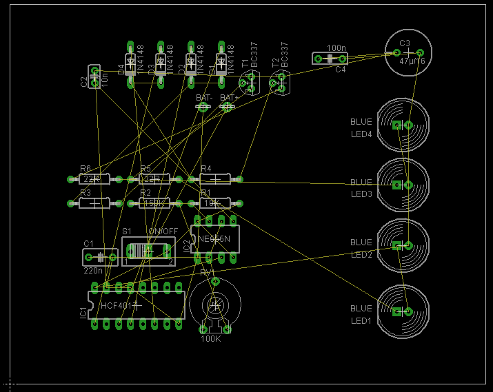

When the schematic is finished type "board;" and answer the silly question "Do you want to create a board from the schematic?" with "YES".
Voila, there is a board (frame) and all parts you used in the schematic are located outside the frame, exactly connected as in the schematic by air wires.
Group all parts and move them onto the board. Thereafter you might move each individual part where you want to have it.
Check the air wires. If there a lot of intersections you'll get problems when routing.

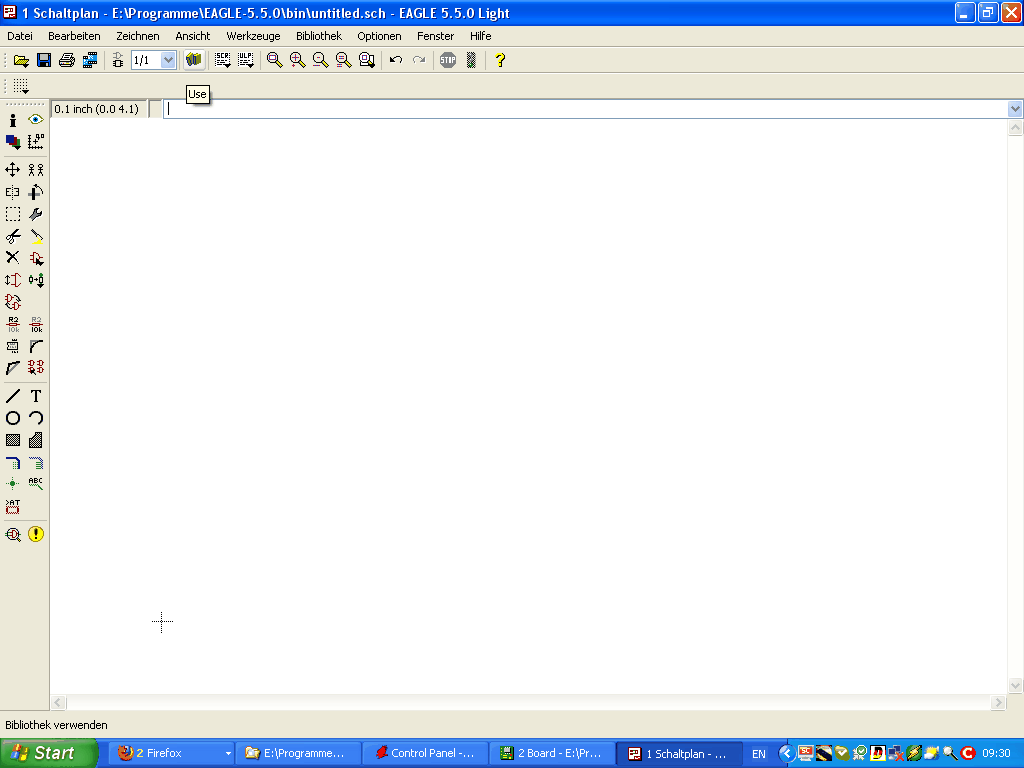

The easiest way to place a part on your schematic is to check the buttons on the left side of your drawing. There is a button with the image of a gate (an 'or' gate I think...) with a cursor over it. When you hover over this button with your cursor, it should give you the help balloon 'add.' Just click on it and select your part from the library.

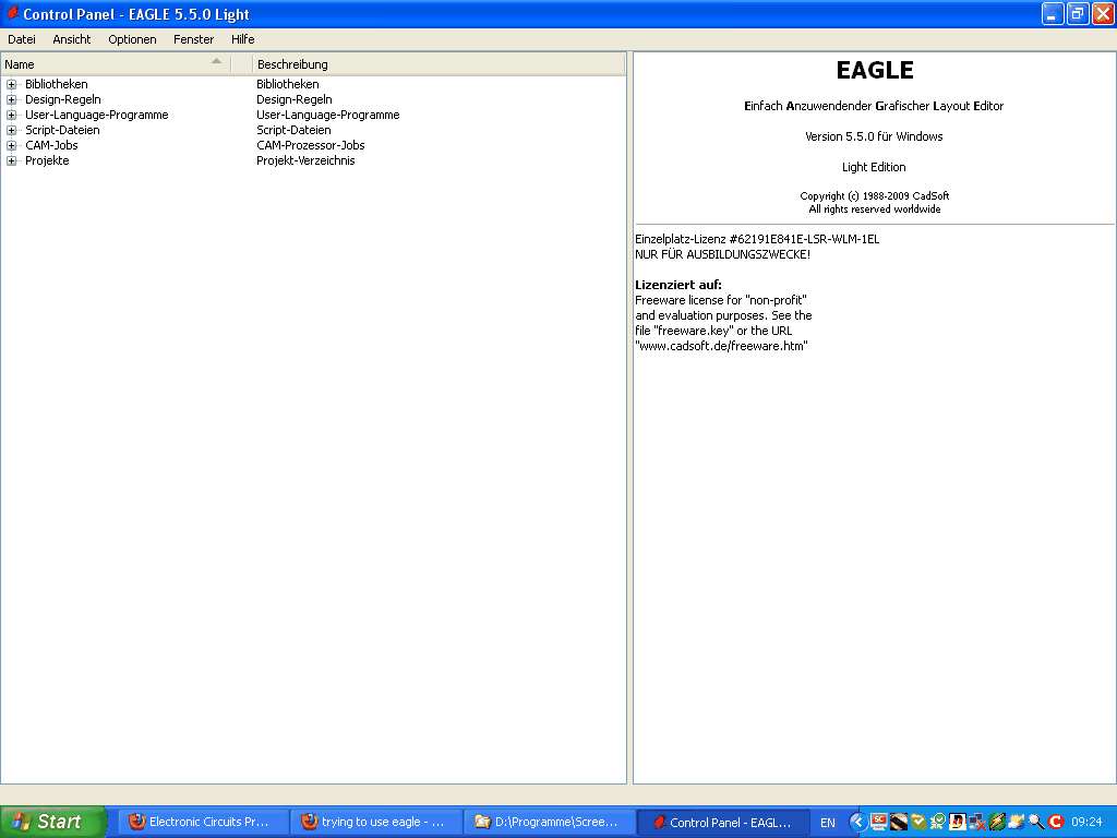

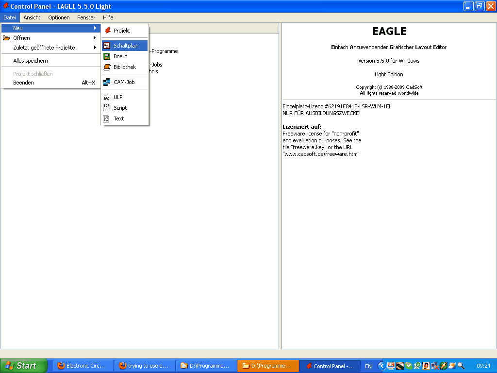

From the control panel select >NEW< --> <SCHEMATIC>. The first thing you'll need is a frame for the schematic. Use the library symbol to find the library named "Frames" or use the "ADD" symbol (Add works faster).
When selecting ADD you'll get a list of all libraries. Type "fr.." and Eagle stops at all libraries starting with "fr". (There is only one starting with "fr".)
Select DINA-4L (A4-size frame landscape, "P" indicates portrait orientation).
Click the name and throw it onto the screen with the left hand bottom corncer matching the zero/zero reference marking.

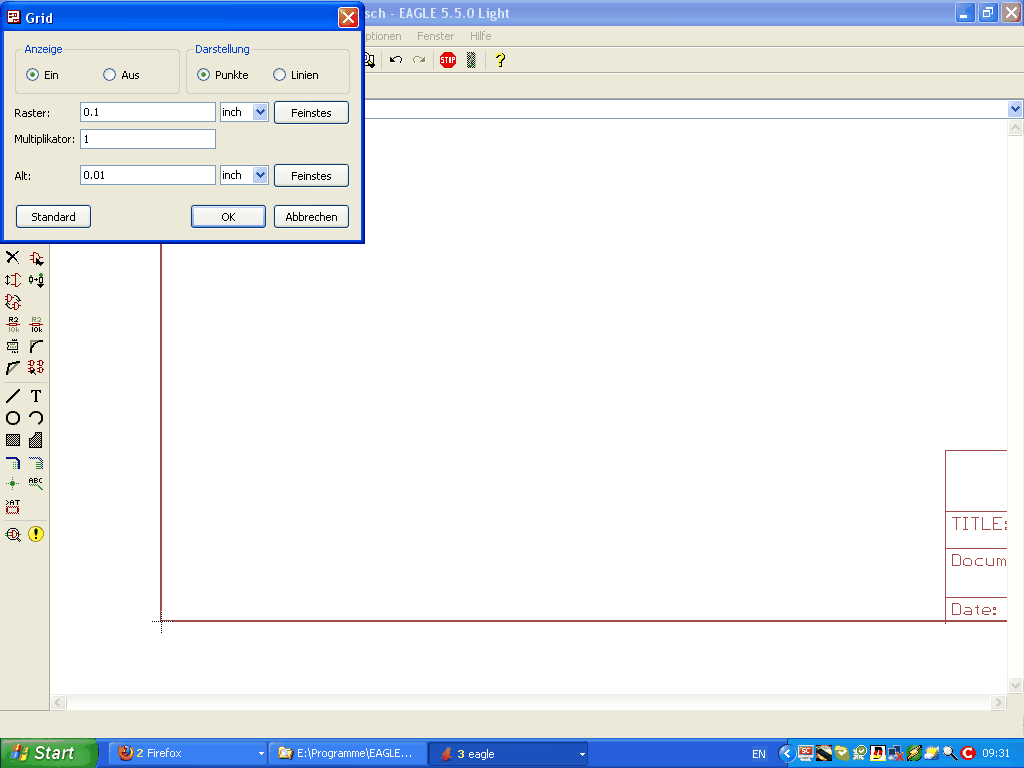

Next you want to use a grid for easier placement of components and drawing nets. Select "GRID" and there select "grid on", and "dots". The grid will start with a standard setting of 1/10 inch. You might change grid size (important for labelling and final "cosmetic" work when the schematic is finished. Use grid size 0.025 inches when putting labels next to nets.

Use several small groups of components to move them into the frame. Grouping elements and moving them into the frame - exceeding frame size - will lead to error messages concerning the max board size of Eagle light (100X80mm).
