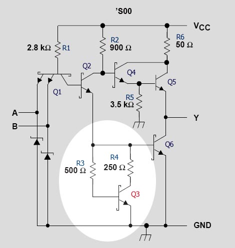

TTL Schottky family turn-off delay time reduction
amerion
Hi to all;
Dose anybody know detailed description of the 74S00 internal circuit?
I would like to know, how R3-R4-Q3 reduce turn-off delay time of Q6.
anybody can explain it?
Thanks in advance.
Amerion
