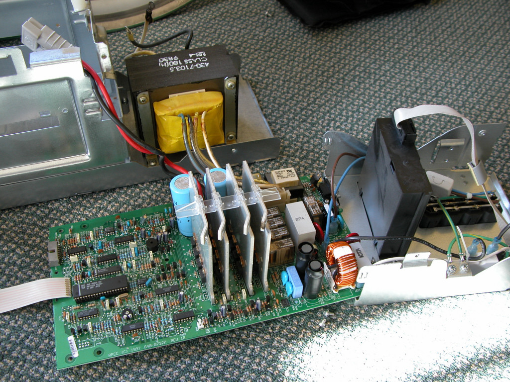

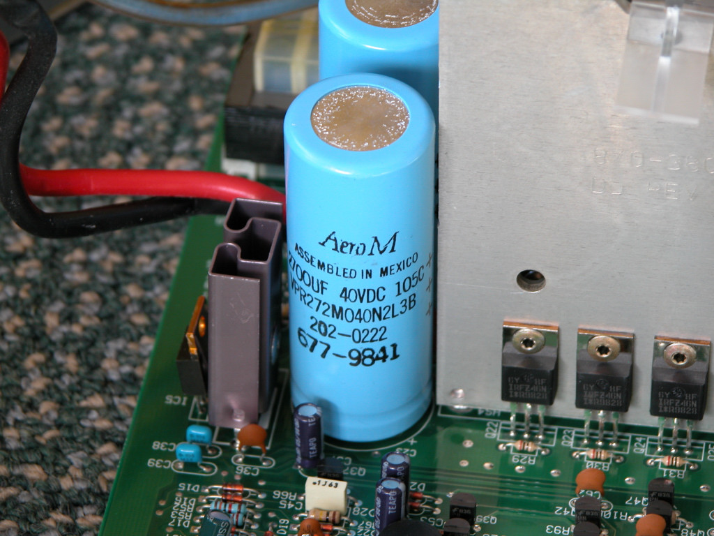

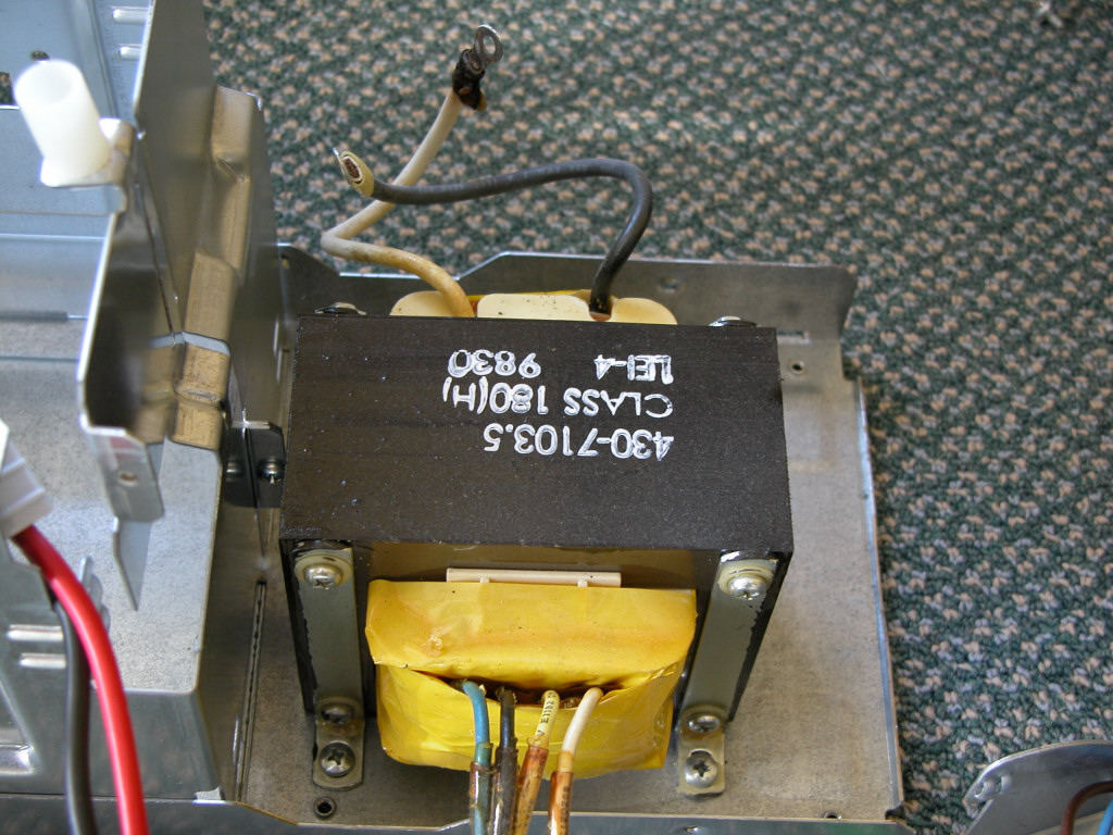

photo's of UPS at semi-dissassemebled stage
Hey Everyone, thanks for help so far, these are some photo's of the UPS at a semi-dissasembled stage (can't spell sorry). Let me know what other technical photos or what other information will be useful in assessing if this can be turned into a part time inverter.
What does an inverter actually consisit of, I can very clearly see (what I assume to be) the transformer, does the rest of the circutry do what?

Anyone had any more thoughts about the Sine wave UPS to sine wave inverter idea's?
what exactly are your specific questions? google and the forum search function will provide you with all the mind numbing details of how a inverter works.
generally the UPS firmware is custom programmed to work with a specific battery (or set of batteries). If you cannot provide a matching replacement battery, your UPS will complain there is a problem with the batteries, and may not operate in backup mode. this is especially true with "smart" ups which have very sophisticated charging and maintenance circuits.
you've got an excellent and once very expensive UPS there ... find the proper batteries for it and use it as it's intended would be my best recommendation.
