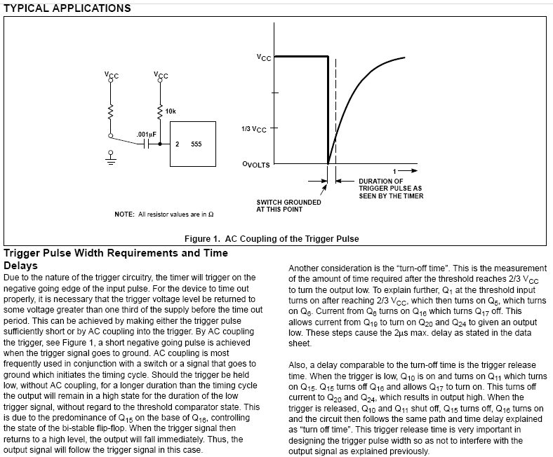

Pin 2 must be high again for the monostable to time out. You can capacitor-couple a short duration low-going pulse to pin 2 for triggering and have a pullup resistor on pin 2 to make certain that it times out if the input signal is still low.

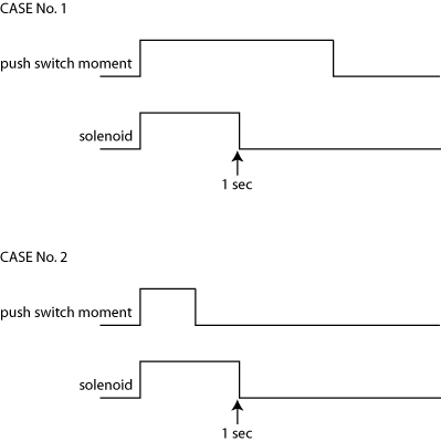

my circuit is not using trigger pulses it uses a momentary switch that could be on for more than the time of the time constant of the Res/Cap.
The closing of the switch would be connected to a C/R differentiator which will generate the trigger pulse
[once only] when the momentary switch is pushed.

Hi again,
Here is a graph to illustrate both scenarios.
if it helps...

I Eric,
I have looked all over the place for the explanation of the pin 2 voltage requirement for it to time out, that you posted.
It is too bad you saved and posted it as a fuzzy JPG file type instead of as a very clear GIF or PNG file type.
I made it black and white to eliminate its colourful bits but it is still fuzzy.
Its getting closer!.
Build this extra bit, then get the 5 Second timing correct.

Attached ne555.pdf, is this what you mean?

I knew that Signetics invented the 555 then was taken over by Philips. I should have looked on their datasheet for the info. I have the Signetics databook somewhere in my library.
I copied the PDF page as a very clear PNG file type. It uses fewer bytes than your fuzzy JPG file type copy.
