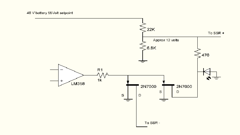

G'day Guy's,
Finally found some free time to draw up a schematic of what I want to do with this shunt reg mod. The voltage divider is there mainly to power the SSR and the RED LED using the second 2N7000 as a NOT gate. The other 2N7000 is used as the negative input for the SSR.
Now does everything seem in order or is that schematic designed to let out that magic smoke.........

What voltages are the LM358's supply pins (Vcc, Vss) tied to?
Hi Mike,
The circuit runs off a 9v1 zener and has the circuit has run in my shed for years with no problems, thats why I have only showed on the schematic from the second opamp output. A mate asked me to make one up with a different configuration so thats why I'm changing the circuit.
Regards Bryan
Ok, a LM358 running off 9V and gnd will swing its output pin from near gnd to about 7.5V, which is more than enough to switch on/off two NFets. You dont need the series 1K.

Thanks for that mate, now with that 2nd FET to light the LED is that connected right ????

I just looked at your circuit again, and I see that the LED is basically telling you that the SSR is driven. Is that right? If so, why not just wire the LED in series with SSR? The SSR usually has a built-in current-limiting resistor in-series with the photo emitter such that the SSR turns on if it has > 3V across it. Since you are starting with ~12V, why not just put the indicator LED in-series with the SSR input? The forward drop of the LED (~2.2V?) will subtract from 12V, leaving 9.8V across the SSR. The same current will flow in the SSR as the LED.
