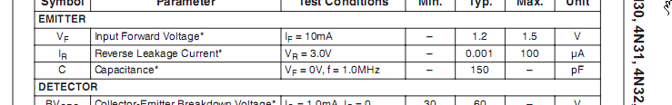

The 4N30 d/s states 1.2Vfwd to 1.5Vfwd at 10mA.
Providing the 1.7V source can supply ~10mA , with a say a 47R series resistor, assuming the 4N30 has the Vfwd of 1.2V it might work, BUT I doubt due the drop across the resistor that drives the existing LED, it will not be able to source sufficient current to fully drive the LED and 4N30.
Hi ericgibbs, I tried using 47R and you are right! Voltage drops around ~1.2V. When I connect 4n30 the LED doesn't turn on but 4n30 works nicely. The LED couldn't handle the voltage drop. I am trying other values of resistor to see how everything would go.

Hi everyone, thanks for the help! I changed the resistor to 120 ohms and now they are good to go. Both LED and Optocoupler now works. :)
