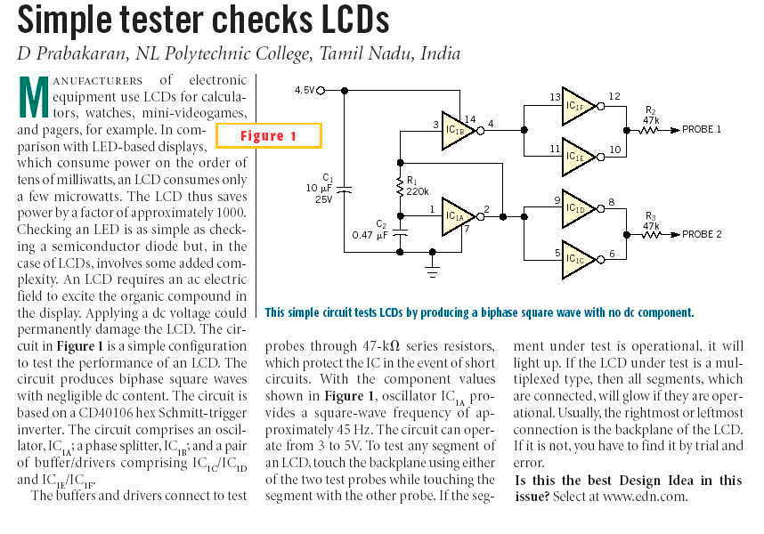

I use this circuit for 7segment display.(LCD2.gif)

The character-LCD module have a driver chip with parallel or serial interface. My test-method works only with "naked" LCD. For testing equal backplane or dot-segment. If You have e.g. a four digit 7segment LCD with one backplane (not independent BP for each digit), this is always the pin1 and/or pin40.
