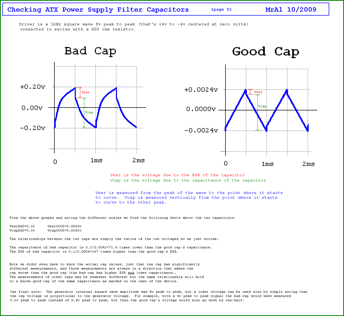

Well i never got around to getting an ESR meter, but i have checked electro caps before using the method in the attachment (using a scope and waveform generator). The voltage across the cap tells the tale of what the ESR estimate would be (note the big difference in vertical scales in the waveforms in the attachment).
One of these days i might get a meter but not sure when.

As long as the set powers up you don't need a waveform generator, simply scope the outputs on the supply rails for excessive ripple - the rectifiers are often through-hole and mounted on the top, so it's easy to scope their outputs :D
Not so easy when they use SM rectifiers though :mad: which is where ESR meters come in handy.

I was very surprised to find that when they go like that they just dont change capacitance by a small amount or even 50 percent, but by a very large amount making them almost useless in the application.
Generally (and I've checked hundreds, if not thousands) the capacitance barely drops, and is almost always well within tolerance - the problem is solely the ESR, which is why an ESR meter is essential, and a capacitance meter useless. Using a scope to check the ripple is effectively testing the ESR, not the capacitance - although in the unlikely event it was low capacitance it would show that as well, and with a similar result. However, if it was low capacitance, it's automatically high ESR as well :D
Interestingly I've seen many PSU's where the reservoir capacitor is completely O/C, yet the supplies still work - apart from a few where the PSU destroys itself under those conditions. You also need to be aware that high voltage caps (such as reservoirs) have high ESR anyway, and rarely fail due to that - because they only work at low frequencies (100/120Hz).
Hi again,
Well the caps in my power supply went down in capacitance by 10 times, from something like 2000uf to 200uf, as well as the ESR going high.
Because after all even with low capacitance and high ESR it is still just an RC circuit, i can tell by the waveform if the ESR is high. It's just easier with a pulse rather than with a low frequency sine so i used a waveform generator. The part where the voltage rises suddenly is the ESR indicator, and the part that slopes upward slowly is due to the capacitance part. If the fast rising voltage change is V while the current is I then the ESR must be V/I, so that part is pretty simple, so i didnt need an ESR meter for that. Ditto for the capacitance but using C=i*dt/dv as the rule. Note also that i removed the caps from the board to test them.
The caps i had been talking about where all relatively low voltage types like 25v or less. The test in post 13 had shown a cap that changed in value by a factor of 71.4 as per the measurements. I wondered if this could have been one of those fake caps that came in from China a while back.
