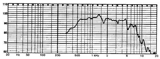

I worked with PRO sound systems in theaters and stadiums. They used horn tweeters because they are directional and very efficient.
But their frequency response was all over the place and they had no high frequencies making equalization very important.
The end result sounded OK but I could hear many peaks and nulls in the frequency response (horny sound), no very high audio frequencies and the equalization increased the fairly high distortion.

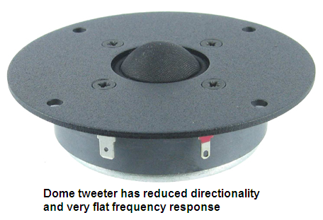

My home stereo uses dome tweeters that are not directional and have a very flat frequency response. Their distortion is almost nothing.
Here is the frequency response of an un-equalized Altec-Lansing Pro horn tweeter and a photo of a dome tweeter.

Altec Lansing horn speakers were called "Voice of the Theater". The width of the horn cause sound waves to relect off the horn back and forth causing a delay and cancel frequencies that were directly produced by the voice-coil producing the peaks and nulls. The horn tweeter voice coils had a very high power rating because the voice coil wire was huge and heavy so they had poor high frequency response.

I showed that an PRO Altec-Lasing horn tweeter has poor high frequency response and its medium frequency sounds have amplitudes all over the place. A horn sounds like a horn (beep beep).
