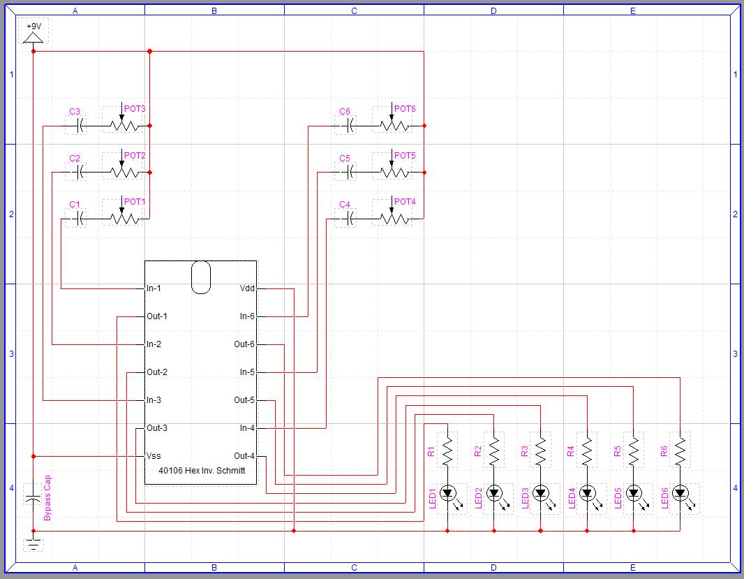

Here is my first stab at the schematic using the 40106.
This is one part of the 5 part module that will power a total of 30 LEDs.
Do i have the connections right?
Thanks again for all your help! :D:D
Nate

About your circuit design Nate, it sucks, almost everything is wrong.
on1aag.

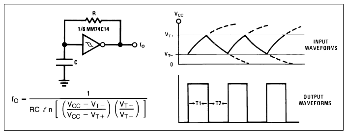

Hi Nate,
The CD40106 is a Cmos Schmitt-trigger input hex inverter package the same as a 74C14. The oscillator nees a capacitor to ground at its input and a resistor from its output to its input.
Its on time is almost the same as its off time unless a diode and additional resistor is added.
They will all start the same and their frequencies will be slightly different. They will look like they are each turning on and off, not random.

on1aag- well at least my idea is alright :p I know i need a lot of work designing schematics, and in circuit logic... but this is my second project... ever... :)
After seeing Hans' response I am thinking that may be a better route to go. I will whip up another schematic for you to laugh at :p But really, i appreciate your comments!
