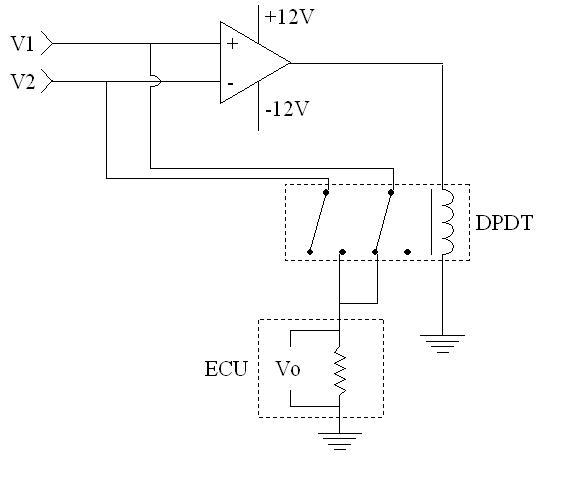

I am working on an automotive application where there are two 0-5V signals generated. The ECU I'm using can only accept one signal so I need to create some sort of device that will compare both signals and only output the highest of the two.
I initially looked at using diodes, but it seems that there will be large a voltage drop, so the output signal will not be the same as the largest input. After a bit of searching on google and wikipedia I've come up with a first draft of something that might work. I've attached it below. (don't laugh!)
V1 and V2 are the input voltages from the sensors
Vo is the voltage as detected by the ECU. This should be equal to the largest of V1 and V2
The way I want this to work is that when V1 is greater than V2, the output from the comparator is 0 (0v). The relay remains in the same position as drawn, and therefore only V1 is connected to the ECU. When V2 is greater than V1, the output from the comparator is 1 (12V) which drives the relay and therefore only V2 is connected to the ECU.
I'm pretty certain that i'm missing something important so any help would be greatly appreciated.

Just a random thought...
As this switches, there will be a brief moment where there is no signal going to the ECU. This might result in an out of range error, so could I use a capacitor to ensure that there is some voltage going to the ECU when the signal disappears?

Minor note:- They are op-amps, not comparators. That might be splitting hairs.
Your relay circuit used a comparator, and the output was expected to be either max or min, nothing in between. The precision rectifier circuit needs the output to be stable if the feedback is working, so an amplifier that will be stable is needed.
IMinor note:- They are op-amps, not comparators. That might be splitting hairs.
I don't think that's splitting hairs. A dedicated comparator has no compensation so will oscillate if you try to use it as an amplifier with negative feedback.
As you noted, the precision rectifier needs a stable amplifier which can accept negative feedback, which means an op amp.
Of course you can use an op amp as a comparator but it will be relatively slow, due to its compensation, as compared to a dedicated comparator IC.

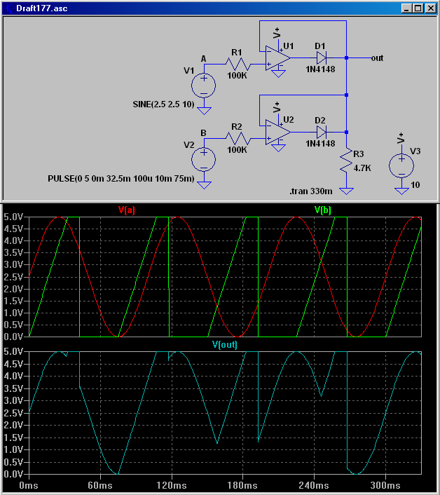

This illustrates how it works: The opamps need to be rail-to-rail in and out. LM358 would work. Depending on what the output is connected to, you may have to buffer it.
Thanks Mike, that response trace looks perfect for what I need.
What purpose do R1 and R2 serve in that circuit? At the moment I have the 0-5V signals going directly into the op-amps.
If you can absolutely guarantee that the input signals NEVER swing below 0V, then you can leave them out. Otherwise, they prevent the opamp from excessive currents if the input swings below ground...
Depending upon the op amp design, it also can protect the inputs if there is input voltages present with the op amp not powered.
