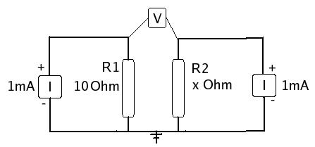

I'm wondering if there will be any problems connecting the current sources in this way? Will I damage the current sources in any way?
My teacher said he had a problem with ground loops.
/P

Get a new teacher!
Your teacher appears a bit looped. There is no ground loop and your connection will cause no damage to the current sources.
So there will not be any damage to the current sources?

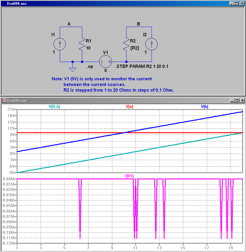

Look at this simulation: I am using a zero voltage source V1 to show that NO current flows along the ground connection between the current sources. Note that the simulator shows 0.11 femto Amps, which is within the numerical noise of the simulation! Note also the voltages at A and B, and the differential voltage between A and B. The X-axis is the resistance of R2.

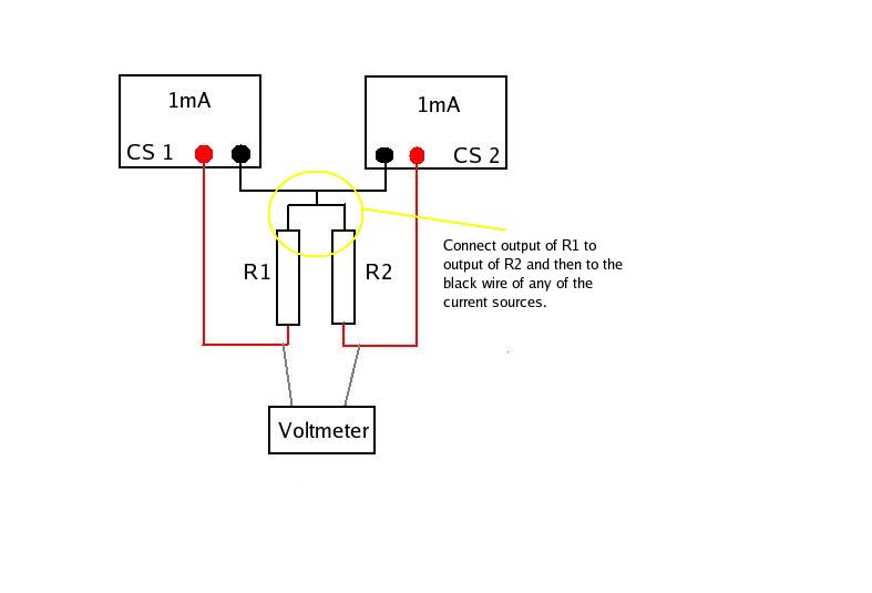

Sooo.. just to be sure (because i'm new to this).
If i connect the black wire (the minus one) from current source 1 to the black wire of current source 2.
The red wire of CS1 to the input of R1 and the red wire of CS2 to the input of R2
Then connect the output of R1 to the output of R2 and then to the black wire of any of the current sources?
The first two steps are fine. That is all your diagram showed. The voltmeter you showed in the diagram by definition is a very high impedance device, so draws no current.
I don't understand this at all? This was not part of your original diagram?

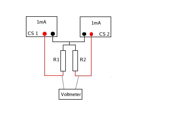

Hmmz? Isn't it? Look at my new diagram, is that okay?

You second diagram is just an upside down version of your first. It is topologically the same as what I simulated.
Yes but you said you didn't understood this
"Then connect the output of R1 to the output of R2 and then to the black wire of any of the current sources?"
You understand now what I mean? :)
