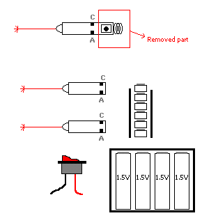

Need help in how to connct 2 optical laser pointers togather in one circuit using one battry 9V with switch to awitch ON/OFF the lasers togather

I attached image of the parts please provide me with the best solution to connect them to keep the system running for longest possible time (without using power supply)

Little coin cells don't have enough power to light a laser for much time. They don't have enough power to cause damage from too much current.
Larger AAA or AA battery cells can easily blow up a laser due to too much current so a current-limiting resistor MUST be used in series with the laser.
Wire the thing like this.
The resistor's value is calculated with Ohm's Law:
The voltage of the battery minus the voltage of both lasers in series divided by how much current you want in the lasers. Too much current and they blow up.

No.
Ohm's Law says that the value of a resistor is calulated by the voltage across the resistor divided by the current through it. The voltage across the resistor is much less than the supply voltage because the two lasers are in series with it.
How many volts for each laser? 2V? Then the resistor has only 2V across it.
A laser doesn't work at the very low 4mA that you used. It needs at least 20mA or more. But too much current will burn it out. You need to measure the original laser circuit to determine the voltage and the current.
Add an LED in series with a current-limiting resistor. If the supply is 6.0V, the LED is a 2V red one and its max allowed current is 30mA then the resistor has 4V across it and 25mA through it which calulates to a 160 ohm resistor. A 180 ohm resistor makes a current of 22.2mA.

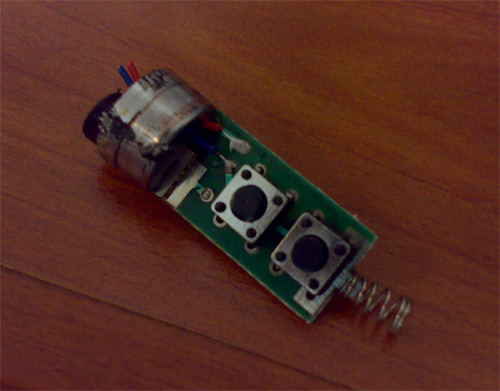

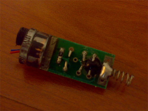

Hello
I opened the laser pointer and I found this cirucit
I need help to measure it
the laser came with lamp that was connected to blue and red wires
I cut it because it is not needed
please see the attachment

I have a little laser pointer.
It uses 3 alkaline button battery cells (a total of 4.5V without a load) for power. The internal resistance of the battery cells reduces their current to about 30ma to 40mA to the laser that is about 3V.
I don't know the voltage of your laser diode and don't know how much current will burn it out.
The voltage is low so it is difficult to measure the current. A current meter will reduce the current.
i dont know where you get your lasers from, but mine have additional resistor behind the laser diode, i ripped about 6 of them appart (they're cheap here $1, 3 batteries included)
all i do to mine is feed 4.5V directly from my LM317 and that's it, 3 AA will do fine
Button battery cells have an internal resistance that limits their current so the laser is not destroyed. A laser needs about 3V at about 40mA. Then the 4.5V worth of button battery cells have a total internal resistance of 37.5 ohms. Your 4.5V LM317 or 3 AA cells will burn the laser out.
Maybe the extra resistor is in series with the laser to help limit the current.
