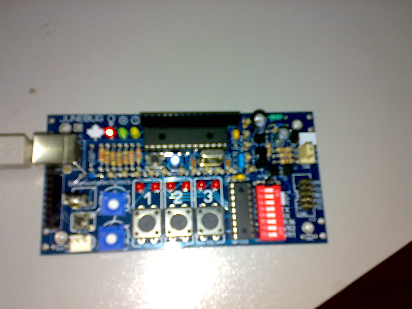

Hi I got everything ready on the Junebug PCB. I programmed the 18F2550 with a TOP2005 programmer(my friend's), the problem is that it says that no configuration words have been set. Are we supposed to manually set configuration words? Arent they supposed to be part of the hex file? I am using version 2.32 of firmware.

When i do plug it in(expecting a miracle lolz!) it says that no PICKIT2 detected(duh!). :(

Is it a Junebug clone or a selfmade copy? The kits include a preprogrammed 18F2550. And yes you can use the 2.32 hex file.
One quick test is hold down the bootloader button on powerup, the LED will flash if it's programmed.
Hi Bill sorry for late reply.I have posted a picture of the Junebug( I wanted to start a big thank post for the PCB once i got it working).The power LED is fine, the 18F2550 power LED is faint but i get 4.92v on it(the same i get on Vdd and Gnd from the USB port).I have already done the tests written in your manual, the busy LED doesnt light up when bootloader switch is pressed.I think it is a matter of programming the firmware. I did put my question that when i program my chips(all 4 of them the 18F2550's) the programming works great(except the encryption part) but it says that no config words have been set. I guess thats the problem for it not operating. Is this supposed to happen? I mean if it does ask us to set the config words, what am i supposed to set, the usual like
OSC=lp,WDT=off ??
I could whip up the parallel programmer(LVP) but i think one cant LVP a HVP'd chip right?

You can try an LVP programmer on the 18F2550, another user here claimed it worked for him on a DIY Junebug.
Hi Bill i got the Junebug working( i guess you can LVP an HVP'd chip which has not got any configuration words). But there is a hinch to it which is that the target power LED droops(nearly closes) in most USB ports(be it my laptop or my PC). I am going to change the wire that i use to connect it but the power supply to the tutor and the programmer power LED is fine. Its the firmware powe LED thats the problem.Is it because of the wire?? If not what could be that sometimes its working and at others it is not.

Bypass VDD control with a short wire between +5V & U5V
Hi Bill, the very faded LED actually means that it doesnt detect an IC there!
Also when it does recognize something(its like luck you pull and put the wire in and out the socket and hope it reads the IC) it says that 'Unrecognized USB device' even after i reprogrammed the IC with the Low Voltage Programmer.
Also i found an old post in this forum in which 3V0 said that he resolved this error by using a .22uf capacitor on C6. That didnt work out and i accidently damaged the upper ring of that hole. I have pushed it down and it seems to be working for now( i will need to solder it from the top side as soon as i get it working).

Ideally C6 (the internal USB voltage regulator filter cap) should be 0.47uF but 0.22uF should be fine. 1uF might work, never tried it though.
I've never figured out or tried an LVP programmed 18F2550 although I'm told it works I'm not fully convinced as an LVP PIC required the LVP pin to be pulled to GND for the chip to run and the LVP pin is the bootloader button!
That said the config fuse must be correct for everything to work. Make sure your programmer is setting them correctly.
