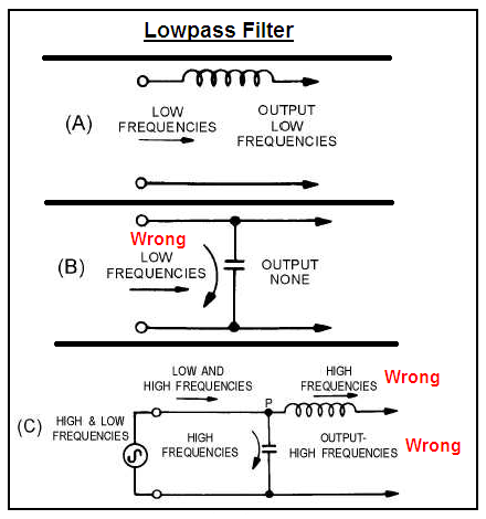

i got this info from allaboutcircuits.com
and www.tpub.com/content/neets/14181
what do u mean by there is no parallel connection of Highpass and Lowpass?Why not?But i read in Floyd too that conting these in parallel gives bandstop.What i am really confused abt is

Hi Niga,
No wonder you are confused, your posted document is plainly wrong!
A) Low frequencies pass through an inductor. Correct.
B) Low frequencies pass to ground through a capacitor. Wrong.
High frequencies pass to ground through a capacitor.
C) High frequencies pass to ground through a capacitor. Correct.
High frequencies pass through an inductor. Wrong.
The output of a lowpass filter is high frequencies. Wrong.
The output of a lowpass filter is low frequencies.
