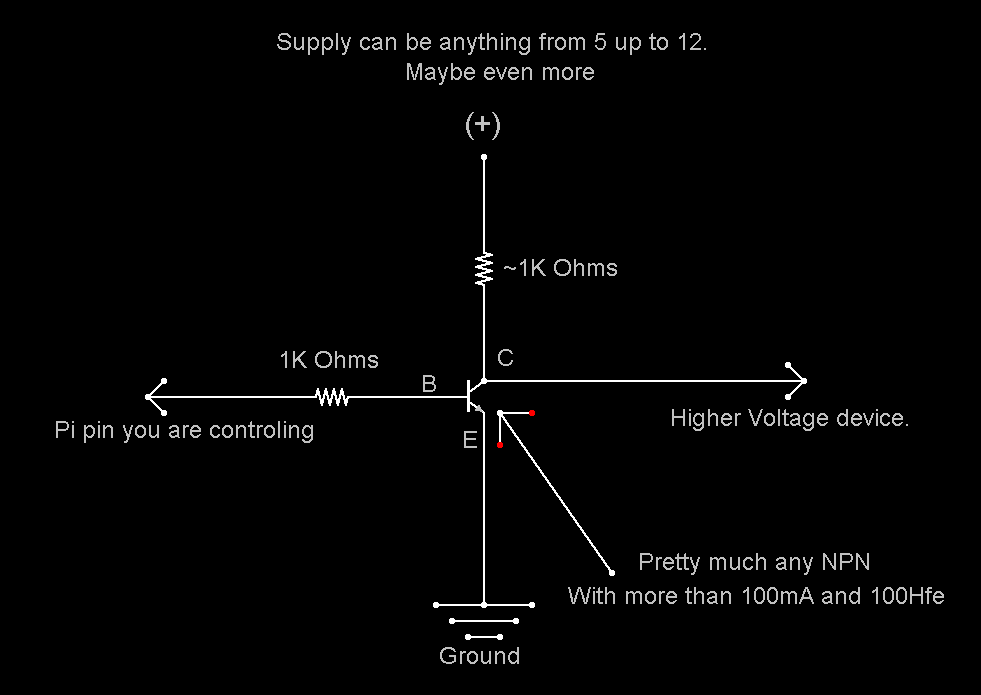

In any case, as promised I have attached to this post the Raspberry Pi v2 PWM control program, and source code that lets one do servo control(among other things) with just the Pi and a dirt simple buffer. I also went the extra mile and wrote a whole lot of safety and explanation into the source for the kids. Know that to simply achieve the underlying fundamental task, I didn't have to do any of that. It was as easy to do as I though it would be.
The precompiled executable file has .bin at the end, take that off when you load it into the Pi and try and run it. I did this just to bypass ETO upload filter, it won't run named like that. So, RENAME the file from PWM_PIN.bin to JUST PWM_PIN when you have it on the Pi. When your done, execute with "sudo ./PWM_PIN" for a rundown on how to use it. I hope this is clear enough (^_^).
Hardware
To use this program with voltages other than the 3.3v of the Pi it's self, you obviously need to have a buffer of some kind on the pin. I chose to use a simple npn common emitter buffer. This is an inverting design, so the off and on time parameters entered into the program need to be switched if you use it. Here is the schematic for such a buffer... (not that it's needed for most of us).
Other notes.

I can explain how they are used. The "void *gpio_map" is practically useless.. It is used as a temporary variable inside the "setup" function. I don't know why the code is written that way.. strange.
Hardware
To use this program with voltages other than the 3.3v of the Pi it's self, you obviously need to have a buffer of some kind on the pin. I chose to use a simple npn common emitter buffer. ...
Most servos (pretty much ALL servos) will work fine with a control signal of 3.3v or 3v amplitude. Their input stage only needs about 2v to trigger and register an input pulse. So the transistor buffer might not be needed. :)
That's good to know. That makes it even simpler. I just figure 5V servo, so 5V input. And of course, the circuit is intended to cover a whole range of other basic PWM projects, not just servos. But truly, servos were the primary goal.
