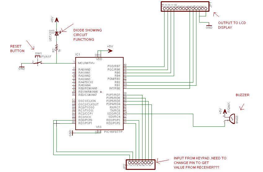

pls help me.urgent!!i am doing tyre pressure monitoring system..i enclose my circuit design and coding.i used to use keypad as my input value and output to LCD.now i need to use value from pressure receiver as my input.the receiver i m using is RLP434 or RLP434A.
the pressure receiver receives data wirelessly from the transmitter which get values from the sensor in the tyre.how can i change the input at the circuit and how can i change my coding according to the change.
as for output, my target end result is that if the receiver receives values range from 0 to 100 psi, output of LCD will show 'VERY LOW",at the same time,buzzer on the circuit will activate.if the values range from 100 to 200 psi, LCD will show 'LOW', if more than 200psi.it will show 'NORMAL'.
pls go thru my circuit design and coding..teach me how to make the circuit and coding works for the requirements.TQ

wow, that coding is pretty bad.
You are comparing a number to an array in your check() function.
I believe the LCD_putc is for sending individual characters to the lcd, not strings.
Your buzzer will be on until a 'very low' pressure is read.
But i guess that doesnt really matter since it will all have to be changed when you actually read in the proper pressure signal.
Do you have a datasheet for your reciever?
I didnt know there were tires that needed 200psi to be 'normal'. That would be a pretty big bang if one were to blow out.
I question the wisdom of using the RLP/TLP line - especially the TLP which will be subjected to some pretty extreme stresses. But then, my guess is the instructor selected this model and not you.
how does the RF input actually get received? Where do you talk to the RLP? I don't see that at all.
yes, 200 psi is way high - I'd look for a 0-50 range.
I concur, the coding is pretty bad. there are multiple problems and a complete lack of logical orgainzation. the index to the array will be out of bounds in check, it's a valid use of an array. however, you use the identifier k in get_input as a char but globally as an array of ints. that's not a good idea. use a different identifier.
Frankly, trying to fix it looks like a waste of time. I'd just start over. think about your program as a process - what steps would you do manually? write down the sequence of steps in simple language. try to structure your program that way. keep different parts as self-contained as possible. For example, why do you initialize the LCD controller in "get_input"???? try to use function names that are actually indicative of their usage.

so how's my declaration for the data..r they alrite?where do i need to change them..
erm..what should i do on the first step to coding?because when i test run the coding..it does not show any error..i thought it is alrite...however..i have to rewrite the coding now..
how about my circuit design,is it alrite?
