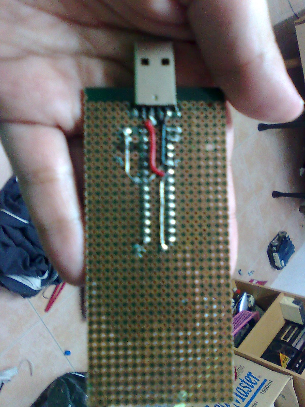

So I've built the UBW (only the USB connections, no LEDs or other stuff yet), but the so-called hex files which which needed to be loaded into the PIC beforehand is not there. The part where it says See this page for help doesn't have a hyperlink.

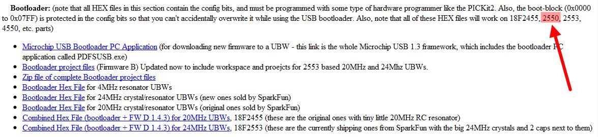

Near the end of the page you'll find the bootloader files
06122009_120225-jpg.36063

There's a hitch here.. I loaded the hex files into my 2550 using PICkit 2: But after verifying it, it said "verification of program memory failed at address 0x00000.
The PICkit hardware detected it nicely though. Is it damaged?
Double check you connections. Do you have anything else connected to MCLR?
During programming MCLR should have a diode+resistor from Vdd to ensure Vdd does not see 12V. Your 10k resistor should be enough to prevent Vdd becoming too high or Vpp too low but that depends on the programmer.
The only reason I asked was because it sounds like the chip is not getting into programming mode which is usually inadequate Vpp - 12V.
To program a pic the programmer has to put 12V on MCLR. Most USB programmers have some kind of DC to DC converter to achieve this.
You can't substitute, it has to be a 2550.
