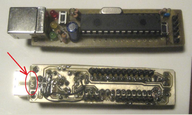

I've seen the famous UBW project (**broken link removed**), a simple development environment for 18F PICs. The site has 5 different versions of the board/schematic with an easy-to-use 28 pin DIP package.
Do you know if (and where) it's possible to buy just the PCBs of some of the 5 versions? The only way I know is to buy a complete kit, assembled or not, from SparkFun (here).
I'd like to build some boards but most of the board revisions need double face PCB with holes metallization ... to complex for DIY.

This is a rough layout. The red top layer is to be replaced with jumpes. If you feel you can etch and build it I will clean it up and fix the clearances. There are a few lines between traces and one jumper under the PIC.
EDIT: uploaded better image.

Three files are attached.
The .zip contains Eagle files. Only the .brd file is modifed, the rest are as Brian provided them.
28DIPA_SS.pdf shows the layers in color, jumpers in red
28DIPA_SS_PRINT_ME.pdf is the actual image you need to print if you do not use Eagle.
I increased the size of pads and spacings to make it easy to drill and solder. The pads on the USB jack are close together. After etching check to be sure they have not been joined. Note that I have not constructed a UBW from this exact layout but the schematic is unchanged and there are no unrouted wires etc so it should be OK. :) (cover my butt)

I got my first batch of 5 circuits a couple of days ago and I'll mount and test them in the next few days. I'll let you know.
Thanks again to 3v0!
At last!
Hi 3v0.
Here is the UBW done with your PCB (as you can see).
It's working perfectly.
Thank you again.
