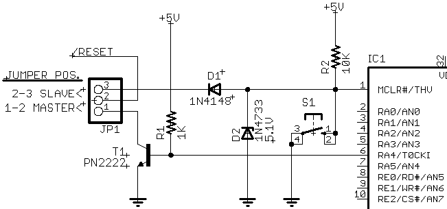

I am creating a general purpose (mainly robot) controller board for my personal use that includes a 'network' interface for connecting multiple copies of this board together along with anything else that I may want to connect to it in the future. I want this to be flexible for future unknown applications. I am trying to determine the reset circuit for the board (and thus network).
My design REQUIREMENTS are:
-One single hardware design
-A single master, one or more slave network arrangement
-PIC uC (most likely 16F877A, but perhaps 18Fxxxx)
-Software is customizable for each board
-Use RA4 for controlling the network reset signal since it is open collector only (in other words - save the more useful I/O for other purposes)
-Config jumpers are fine since it is for personal use, but avoid if possible for convience
-A single header pinout for the master and the slaves
-Each board have a reset button
My PERCEIVED goals are:
-Master is in charge of asserting the network reset
-Network reset is active low (/RESET)
-Slaves can enable or disable the external reset signal
-Master holds all attached devices (that choose to enable the external reset) in reset until master is ready
-The maximum number of these identical boards connected together will not exceed 3 (1 master, 2 slaves)
-Whatever 'other' unknown devices that accept an active low reset signal may be on the reset circuit (max 5-10)
-Allow devices to have different VCC's and still respond to the network reset and not effect other nodes
-Assume that slaves have pullups for their reset circuit
These are PERCEIVED goals since this is what I currently think is best, however, if someone thinks that I should do something differently, I will certainly consider changing.
Attached is my proposal of the circuit (with circuitry unessential to this topic ommited). JP1 will allow the board to be either: the master and assert the /RESET (jumper over 1-2), slave and accept the /RESET (jumper over 2-3), or neither assert or accept the network /RESET (no jumper connected). JP1 pin 2 is the network reset circuit (that is brought out to a header).
My circuit theory:
For the master: On powerup, the master's RA4 will be in a high-Z input state, and that will allow T1 to be biased on and asserting the network reset. All attached devices will be held in reset. Once the master is up and running and ready, it will change RA4 to an output and assert a low thus turning off T1 which allows attached devices to startup. Pushing S1 to reset the master will cause RA4 to go high-Z and cause T1 to turn on and hold attached devices in reset.
For slaves: S1 will reset only that individual node, not any other device on the network. An active low on the network reset line (/RESET) will reset the device and hold it in reset until it goes high.
Will this work? Should I change components or values? I suppose that D2 (5.1V zener diode) is not really necessary since D1 shouldn't allow a higher voltage to pass, huh? I suppose that I'd like to have the ability to connect nodes that have different VCC's.
Should I consider some other arrangement completely? Perhaps having each 'slave' have it's own pulldown transistor? Something else?
I appreciate any advice or critisism.
Thanks,
Rick

I am designing something like that right now...I don't know what tasks you plan to use it with...but for me it is for robotics and each board is like a "co-processor" that deals with different aspects, like navigation, motion control, osbtacle avoidance.
I was not so concerned with the reset configuration across the boards and the ability for one board to reset the other. The way I thought about it was that slave boards would be coded for specifics tasks so that they start up and would set themselves (and their periphreals devices ie. set servos to center) to a safe steady state and just wait. The master board would then send the slave parameters on how the task needed to be performed (ie. set servo to 90 degrees).

This is where my theory for hardware reset comes in. At this point the system is dead, and without a 'hard' network reset, will require user intervention. Since the master realizes that the slave has a problem, and can assert a 'hard' reset to the slave board(s) and have a chance of recovering the system without user intervention. The master itself will not reset, so it can intelligently recover the network (update the servo co-processor, etc.).
A 'soft' reset (a reset command sent across the network) is a good idea, and perhaps useful, but if a slave has stopped operating it cannot respond to a 'soft' reset message from the master.
I agree with all the functionality that you describe, thanks for taking the time to post. The hardware reset is not meant to replace that, but rather add another 'layer of protection'. Also, since I am unsure of future uses, I'd rather add the circuitry and never use it, than not have it and need/want it later. Plus it doesn't cost much, either in terms board space, coding, or money.

A soft reset would be best because it is more flexible and require no extra hardware. If the uC does not have have a software reset (for God knows what reason) you can always attach a digital IO pin to the reset pin and have the uC hold it in the appropriate state (or use pull up/down resistors to have it operating and have the uC pin pull it to the appropriate level to reset).
However, when something malfunctions...YOU DO NOT NEED TO BUILD YOUR OWN HARDWARE RESET...because it's already built in! Most uC have what is called a "watchdog timer". This timer runs independently of the uC and periodically checks a register which the uC must update periodically. If the register is not updated (ie. the uC has crashed) the watchdog timer resets the chip!
This is so that uC systems don't hang and might be able to recover if something isn't quite right with their code and continue operating.
Convenient huh? That's why I don't think you need to automate the manual reset. My board setup depends on this theory- that the crashed board will use the watchdog timer to reset itself.

I think this is a mistake. There is little reason to have a "network reset" signal because no reliable protocol should require that all the processors reset together.
You need to focus on protocol. I2C is great for bidirectional communication with a single master. Serial, not so good at bidir, good with a single master transmitter. CANBus, good but you need a transceiver chip and an advanced controller. SPI, also fine.
With all these protocols a receiving chip can "wake up" at any point in the data stream and get in sync with the transmitter within a byte or packet or so.
As said, WDT will do a great job of reliability. The only thing WDT can't fix is latchup, but even an external reset won't fix that.
Now just why do you need multiple processors? Just using a pkg with more pins can give you a lot of room for expansion. If you need another PWM channel you can get an external PWM chip.
Perhaps the hard reset is unnecessary... I'll just do without and gain another I/O, which would be much more useful (and it's in short supply).

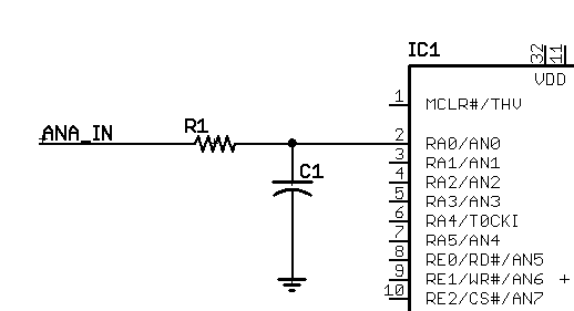

dknguyen said:
You might want to add a few filters onto your ADC pins if to decrease bandwidth (decreases noise at cost of response) if you are planning to do signal processing with your board from external sensors.
I do have 5 I/O that can be used as A/D. Unless more than 3 is needed, I'll assign 2 of them to monitor bat voltages - both main power and servo power. This will be selectable, so that if I need 4 or 5 A/D, I can disable the voltage monitoring, and use those 1 or 2 as GP A/D. I also am allowing the 5 A/D to be able to be used as digital I/O, if necessary.
I am interested in the filter idea, but am inexperienced in analog design. I don't really plan on signal processing (especially with my 16F PIC), but the filter is probably still a good idea. Perhaps a simple RC low-pass filter for each input (such as attached pic)? What would good values for the R and C be? How would this effect digital I/O when the A/D is not being used? It should just slow the digital transitions (softening the edges), and thus limit the switching speed, right? Should I not add the filters since these A/D could also be used as digital I/O? Or should I add them and accept the fact that these can only be used with slower digital signals?

An RC filter is fine to just get rid of high-frequency noise on the ADC line. If you are like me and need to do some complex signal processing on analog signals (like integrating the signal and stuff like that), I went with a Maxim IC filter chip where I can change the cutoff frequency very sharply. I actually need the filter to control the bandwidth of the signal, not just cut off noise.
Do not use an filter on a digital line unless you know exactly what you are doing- it isn't needed and the lowpass characteristics can mess up high data rate digital lines. I am dedicating pins to analog signals and only analog signals on my boards- only those ones will have the filter. It's all up to you how to organize your pins...
as for the low pass filter, Time Constant = Resistance * Capacitance where T is the lowest period of the signal that will be filter. So, 1/T will give you the cutoff frequency where the filtering will essentially start. Its up to you to decide the frequency. Too low a frequency will require components that are too large.
Rin should not be over 2.5K ohms. That is the R plus the resistance of the voltage source it is measuring. You don't always need an RC filter though. I've done a lot of unshielded external sensors near engine ignition and didn't have a noise problem.
