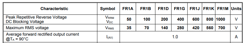

There are many different types of FR1 diodes. If you picked an "A" then you have killed the diode and that will cause MOSFET heating.

the diode is FR107 while is zener near opto is a 11v zener for 12 v output and i do get 12v output. the supply runs small DC gear motors fine. but duty cycle for such small loads (<1A) also reaches to more than 75% which was 1% on no load. i loaded these motors for 15 minutes with not much heating of mosfet but when i load anything more than that (car lamp etc) then mosfet heats up a lot and supply is noisy although everything including mosfet is rated for higher loads.this all happens when snubber resistance is 50k. on small resistance (<5k), sense resistance 0.2R, 1k resistor on sense line and sometimes chip also burns.
