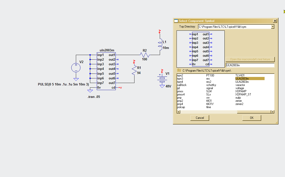

Hi, Are their models for these chips?
Can't seem to find em.
thx Eric!
Hi Eric,
Is there any magic for setting up the directories for these?
You know the trouble I have with that..![]()

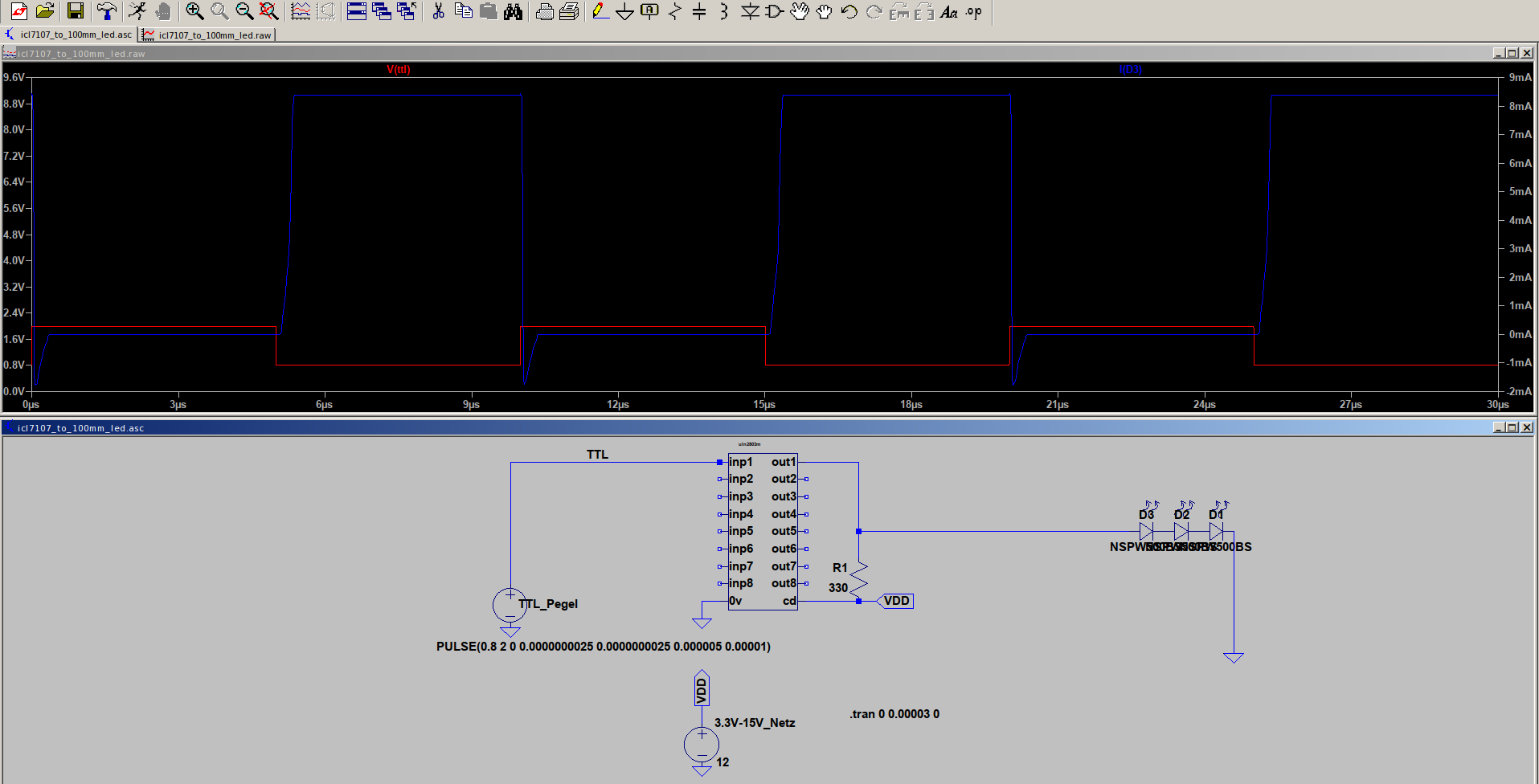

Why bother simulating these old ICs that have a high voltage loss?
The simulation will have only typical values but some of the ICs have much more loss.
Perfect. Thx very much.hi Ron,
These are my folders.
C:\Program Files\LTC\LTspiceIV\lib\sym\ULN2003m.asy
C:\Program Files\LTC\LTspiceIV\MyWork\Digital\ULN2003m.asc
C:\Program Files\LTC\LTspiceIV\MyWork\Digital\ULN2003m_test1.asc
Image shows ULN2003m in the list, when F2 is pressed.
Post back your folder names.
