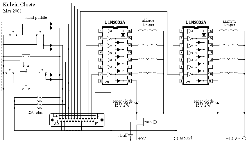

Here is one that I have used with a 16f877 that uses a uln2003 to great success.

spirosd may I ask what that circuit that you posted is for?
Also, why does the pin 10 (pin 9 on the uln2003's) have to be connected to your + voltage?
(and from somewhere the stepper gets 12v, not shown on the picture)
It is used to control the axis of a telescope :p
From the research that I did (both theoretical and empirical) it helps when stepping the motor fast (think about slewing the telescope ... you want something to happen in seconds; it redirects back emf from the motor to the battery/power supply - I believe). In addition is aids the heat dissipation of the ULN (I have also added a heat sink just in case, as I am powering 4V motors at 12V, with a current limiting circuit ... paranoid).
