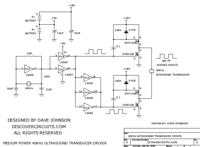

I'm looking for a circuit diagram .... i found a lot , but i don't know which on is the best
what about this attach one ? but i want a single wave transducer ..
The circuit in post #5 uses two 9V batteries. Instead if they are a +9V and +18V power supply then the output will be 36V peak-to-peak.
What is "a single wave transducer"?
