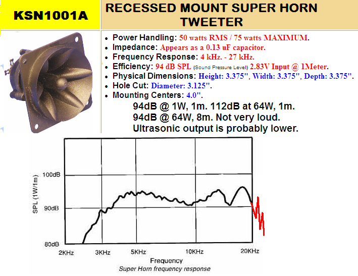

Not really, since ultrasonics have little predictable effect on animals, it's just another loud sound. Tried for a while to keep the neighbor's cats from using my property as their toilet. He had 17 at one point, before I convinced him to cut the population some, since they were adopted strays. I tried several circuits, frequency, and pulse timings, but never got great results, still had a few that ignored it. Fortunately, his lady friend gave him the boot, and got rid of the cats. The last circuit I built, about four years is still working, but I still get a cat from across the street. Still think it was a good idea though. I've got 4 piezo tweeters, each is sent the audio signal sequentially, about 15 second delay before the next, sound lasts about 5 seconds. I intended for around 22kHz, sound it would be heard, but used 555 timers, so kind of drifts do to temperature. Been meaning to redo this with a microcontroller, since the speakers are already install across the front of my house, but isn't a big enough success to spend the time on.
The piezo tweeter that was used on a cheap guitar speaker produces some ultrasonic sounds. It is rated at 94dB/1W/1m but probably at a frequency where it works well, not at an ultrasonic frequency.
If you tune the ultrasonic sound to one of its peak frequencies and blasted it with 64W (its max is 75W) then at 1m it produces 112dB.
200 feet is about 61m so the sound level will be only 76dB which is like a normal closeup conversation.
