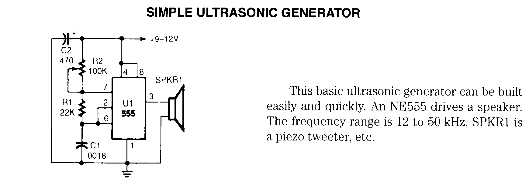

any one know how i might go about building a ultrasonic fogger her are some that i found http://www.mainlandmart.com/foggers.html
if some one could find or make a schematic for me that would be great.

The occilator would work but I suspect the hardest and most critical part will be those ceramic disc thingys that go into the water.

You say with this schematic with 555 can createa a fog? lilke an your link redirection?
Please tell me..with your schematic model, you can generate a 12-50kHz frequency, but i know for create a fog you need 1,6 MHz or 2,4 MHz....
Maybe i wrong...please correct me...
And please tell me C1 and C2 what type of condenser is...and what value
