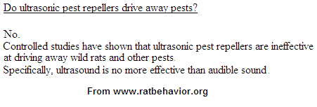

an electronic Pest repellent? how about a cattle prod? :D
I don't know if rats and mice run away from cattle.
I don't know if rats and mice run away from an overloaded tweeter that can't produce ultrasonic frequencies.
Look what I found:
Hmm.. Thanks for the answers. I really do appreciate.
So you are telling me to drop this project. But we need a project that is useful at home. Can you recommend me some projects that are economically feasible to build? Please reply as I need to finish this project this sem. I will look into the forum but please advise me if you have anything to recommend. Thanks again audioguru!
Make the old project but reduce the frequencies so that they are audible then use a normal speaker.
You can demonstrate how it produces switched frequencies and will repel humans.
Maybe you can set the frequencies into a little tune.
