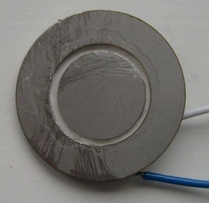

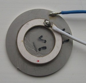

I'm making some ultrasonic 'buzzers'. It is essentially a pzt ring that is glued with an epoxy resin to a thin steel diaphragm. I'm sure most of you have seen the audible buzzers you find in alarm bells, toys and the like, and this is similar. My buzzer is ultrasonic and operates at around 40KHz for resonance so theoretically it should be silent to the human ear, but there is a very noticeable audible ticking that I need to get rid of. What can you suggest?

I've attached a picture of the front and reverse of one I made some time ago, but the one I'm working with is almost identical. The pictured one is a bit crooked, I usually put them on better than that.

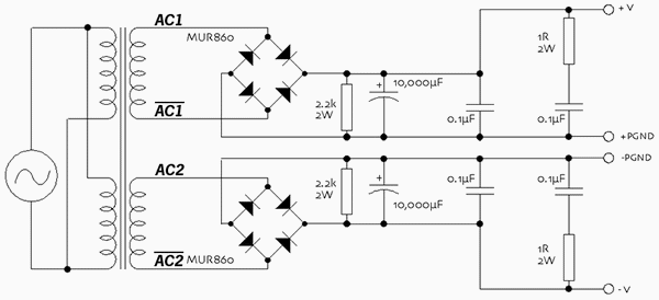

I bought it from https://chipamp.com/?page_id=34 It has the schematic below.

Is the buzz you hear about 100Hz.??
That is an interesting question. The ticking frequency varies with the voltage, at start up (~300V) the ticking is around 3Hz at maximum volts (~600V) it is around 1KHz.
The reason for asking about the 100Hz, is that with 10,000uF caps, the current spikes thru the bridge diodes will be very high.
If the ticking/buzzing increases with voltage >300V I would suspect electrical arcing is the cause. Dielectric breakdown?

I mentioned the general circuit earlier in the thread, in that reply it was slack wording (apologies). So the answer to your question is yes.
My setup is this: signal generator
Mains transformer feeding power board
Power board from chipamp as noted overleaf
Power board supplying +26 and -28 VDC into amp
Amp is OPA548 outputting into a transformer
Transformer is 1:20 miniature audio transformer
(I have this problem even without using the transformer)
What I was wondering when I posted the power board schematic/details was whether there was some kind of offset in the setup at the zero cross point leading to the square wave edge you mentioned.

The whole schematic might be helpful. So you have the same problem at +/- 28 volts?
