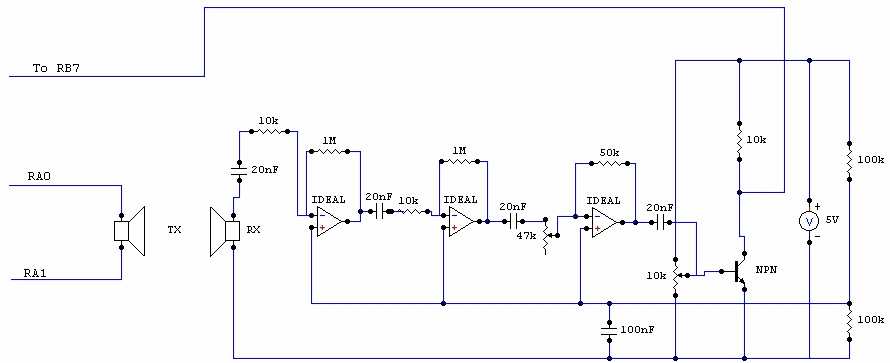

Hey guys
can anyone help me in designing an ultrasonic receiver 40 KHz. I have only one single supply (5v) on my board. The output of the receiver is fed to the PIC. The transmitter is on board also and controlled by the PIC
thanks

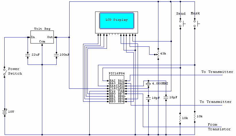

i'm using this:

i found this circuit on the net yesterday but i was confused about the amplifying stage, the gain is 10,000 is it not huge?? cause the received signal is around 5mV and if we multiply it we'll have Vcc practically.
Another thing, can we add the first 2 stage amplifiers in 1 amplifier, so to use a single LM358 in the whole design???
