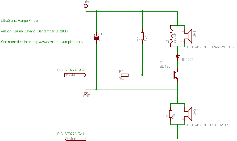

I am trying to get an ultrasonic sensor to work. I bought, and this is the data sheet: https://www.electro-tech-online.com/custompdfs/2008/09/139492.pdf
I have followed this example, mainly for the schematic :
Nothing seems to be working. I don't have the 22 uF capacitor. Is it critical? I have 10 uF, maybe that will do the trick? I also don't have the inductor. Could that be critical?
I am using a pic18f4525 with C18 compiler.
Does anyone have any suggestions or resources where I can try different schematics?

Make 20 uF from a pair of 10 uF in parallel. That will be close enough.
The circuit will not work without the inductor.
Thank you. I am not familiar with inductors and Radioshack doesn't seem to have it. Are there any alternatives, perhaps other circuits?

Looking at that simple receiver, all you will see is a change in the amplitude of the received pulse.
The amplitude of the pulse will not only depend upon the 'distance' but also the reflecting surface.
I wouldnt say the circuit is a range finder, just a ultrasonic receiver.:)

Hi Eric,
That circuit is just a snippet from the project linked to in the first post on this thread. That should provide a usable ultrasonic rangefinder, no? It's broadly similar to my 8051 rangefinder (must get that finished sometime so I can post it) which in turn was based partly on EPE magazine's ultrasonic tape measure project.

hi Thanks,
I used his link named ' here' to find the circuit which I thought he was using.???
Perhaps George will confirm which bit he has built.:confused:

I think maybe he's using that as the receiver stage. Or else just testing that part of it right now. You're right though--it's not completely clear.

I'm sorry I haven't been clear enough. I am trying to build a distance sensor for a robot. I am using a pic18 (which I also have limited experience with). Using the simulator and the timer in MPLAB, I got the pulse to have a period of 25µs. (1 / 40 000 = 0.000025). The sound is very hard to detect.
I have build the whole circuit in the schematic, receiver and transmitter.

Torben's diagnostic at my question is correct (sorry for being unclear). I don't know what to expect from the receiver. Is the detection done entirely in software? Using a multimeter, I don't see any voltage drop over the receiver, and also no voltage drop between ground and the pin I'll be using on the Pic.
I have chosen this particular circuit among the others online because it doesn't use and of the logic gates.

Hi George,
Unless you're a bat, being able to hear the sound at all means it's nowhere near 40kHz. Human hearing tops out at 20kHz.
A multimeter is not fast enough to show you what you want to see on those lines--you'd need an oscilloscope.

Thanks! I have the concept now. I will try checking the status of the input pin. Would the reciever change states if the waves are not exactly 40khz, but maybe 20khz, or 39khz?
39kHz should be fine. 20kHz, no way. The frequency response peaks very sharply at 40kHz and falls off on either side--20kHz will be way too low for it to give you a decent response.

My receiver however is not moving at all. Once its turned on, the ADC gets - 84mV and its like nothing gets detected. Could someone look over my code? I will try and get an amplifier from radioshack and see if that helps.

Yes, I am using the full circuit. Exactly as shown in the schematic, with identical resistors. My inductor looks different than the picture provided, but it has the same 330µH specification.
