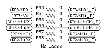

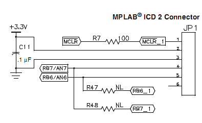

Hmm... I don't think it's that, it's like a value or something... Could it mean they're not present, like not connected? I see them in circuits that could have a dual purpose, but I don't have the board at hand to check. I'm attaching a couple of pictures from the datasheet.

Looking at the drawings you have posted, non inductive resistors would make some sense in those locations.
Ive never seen or used NL to indicate an optional resistor, ie: used or not
Well if those are non inductive resistors, what's their value? There's nothing in the datasheet to indicate what they are...

I think I've discovered what they are. Could NL mean 'no load'? There are a bunch of expansion connectors tied with corresponding ports through 'no load' resistors, though I can't say I've seen so many resistors on the board itself...

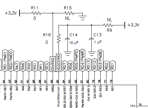

I give up :) I've just seen a 'NL' capacitor, whatever that could mean...

A resistor with '0' value is just a wire link.
Circuit boards often use links that are connected or not in order to select different options regarding the operation of the circuit.
Some board use 'jumpers' either wire links or mini-connectors.

Yes, the 0 ohm resistors are just connections, the 'NL' thing is what's confusing me. Anyway, I'll take a closer look at the board on monday when I get to college and I'll let you know what I find. Thank you again for your insight, it's been very helpful.
Today I've taken a closer look at the board. There are a lot of 3-pad parts. The first two pads are linked with a copper trace and correspond to the '0R' resistors and the middle and last pad are left unconnected and the markings are those of the 'NL' resistors. These seem to be 'optional' features that the user might want to change. Why 'NL'... possibly from 'no load', it's strange anyway :)
