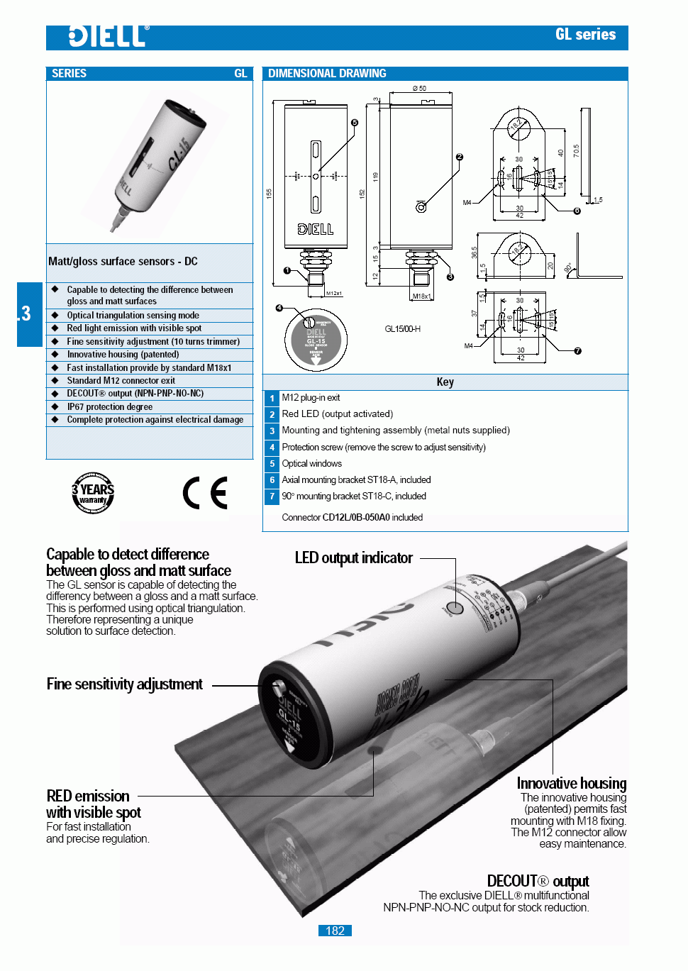

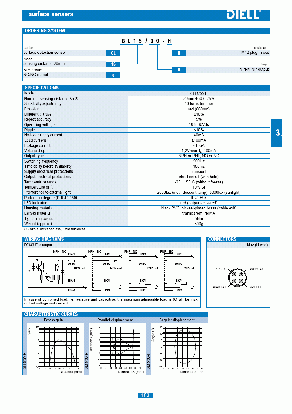

Could anyone plz give me details of the GL sensor numbered
GL 40T-16F/16S
This is an ultrasonic transmitter-receiver pair tht i found in a shop.. But i have no details abt it.

here is a gif image of the datasheet
