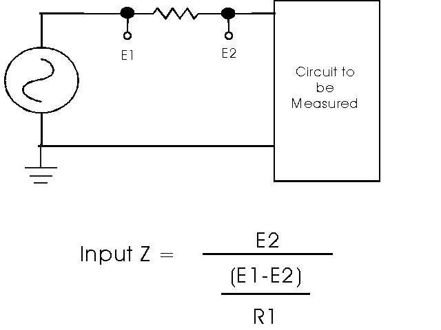

Impedance measurement
The circuit shown is a method to measure the impedance without fancy equipment. It is fairly accurate at audio frequencies. The formula may seem complicated, but by beasuring the voltage drop across the resistor and knowing the resistor value the current into the device is known. With the voltage a E2 the Z can be calculated. The formula takes all this into account.
