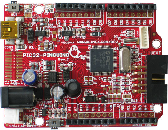

Hi, i'm using a PIC32 development board "Pinguino-OTG":
The microcontroller used in the board is a pic32mx440f256h.
I've tried several types of configuration codes and read functions. No matter what, i can't read the AN11 port (of the pic) which is connected to the AN6 pinheader on the board.
I've already cheched the pic32 datasheet and didn´t find anything that could help.
Also cheched the errata document, and it says something about using the ICSP2 port for programming, which seems to be the one used in my board.
Here is the Pinguino schematic if it is any use.
I first checked disabling JTAG, which shares the same pins than the ADC 10 and 11 channels. it seemed to solve the problem for channel 10, but no luck with channel 11...
Currently i'm troubleshooting with a multitester and before trying any readings from ADC or anything started with a simple code, setting the port direction to output (TRISB=0x0000), then setting the whole port as digital (AD1PCFG=0xFFFF) and sending individual output bits (LATB)...
The voltages for the outputs change as espected for AN0-3 of the board (AN1-4 of the pic), AN4 and 5 of the board show 3,3v. I assume this is because of the I2C port which i'm using and shares pins (still wired cause i didn't initialize I2C in the current project)...
The AN10 and 11 pins show the wierdest behaviour: AN10 shows 0v and AN11 shows 3,3v no matter what i do. As i said before at the beginning i thought it would have something to do with JTAD, but still no luck after disabling it.
I don´t even know if this has something to do with my problem. But i assume that not being able to swith the pins (AN10, AN11) in "digital mode" may have something to do with my problems in analog mode.
Im using Mplab8 and C32 compiler. Also loaded plib, but i've tried writing the raw registers.
