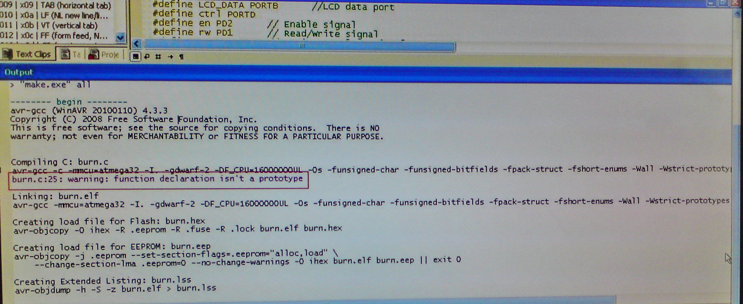

Finally i finished programming my first code and tried burning it onto ATmeag32A micro-controller using Ponyser programmer via WinAVR. The program was successfully burnt but there is a complication.
I have programmed MCU to use 16MHz external frequency (crystal frequency) but now it is working at 1MHz using inbuilt clock. I have made the necessary alterations before burning the program. However, i am not succeeding with it.
Also, i got a warning but my program burning process was successful. Below is the screenshot of the same. Please help me and guide me in correct path.:confused:

Did you set correct fuse bits?
CKSEL must be 0b1111
