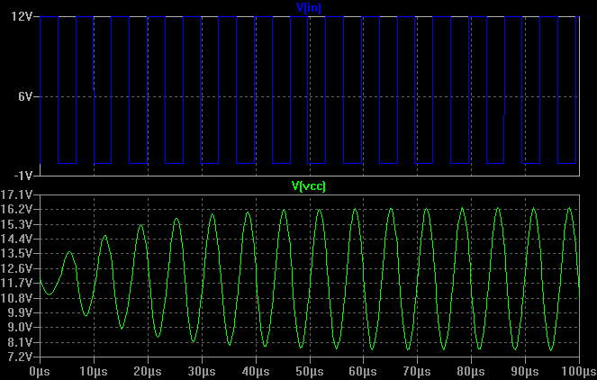

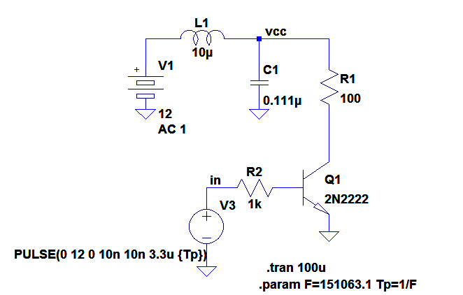

If you mean like in the schematic below, this illustrates the perils of using an undamped LC filter with a switching or high impedance load.

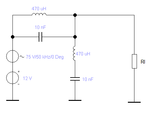

If you want to be exact a 470uH choke in series with the 10nF capacitor connected in paralell with the load might help (Fo would be 73.kKhz) but I don't think you need a tuned filter.
My point is, an LC filter on a power supply can wreak havoc if your load excites it at the resonant frequency.
I see your point you need to watch out for that.
However it wouldn't be in issue for an FM transmitter, or a digital circuit so long as it doesn't switch at 151kHz or an odd harmonicfor exmple a longwave transmitter running at 151KHz or another switching PSU would cause a disaster.
But frequency of the load transients is relatively unimportant. Fast rising, high current edges of a low frequency switching load will excite the filter and cause it to ring. If you have a simulator, try some different examples.
That only happens at frequencies lower than or near the resonant frequency - you won't have this problem with an FM transmitter.
Anyway, I was wrong when I mentioned an inductor, you should use a ferrite bead which is a kind of inductor but it has a very low Q so it'll be damped, or you could go for a tuned filter.
I agree that you won't have a problem with an FM transmitter. I was addressing the general problems that can arise if you use an LC power supply filter without considering the load characteristics.
