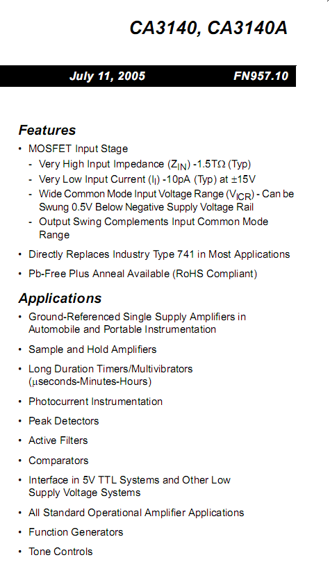

I need a buffer which attenuates the signal. I want to use the + input of quarter of an OPA4140 for the input. Do I just need to string the output across a potential divider, or is there a better way to do it?

At the moment, no greater than V/10, however could go as high as V/30. Can't tolerate any reduction in input resistance since the input is from the DUT on an ohms converter, which could be 100M or more, hence it has to be non-inverting. This is just my route to being able to measure at significant voltage (ie, as high as this particular opamp can stand) across the DUT.
I figured out how to make a fully differential ohms converter but then discovered it needs a single sided mode as well, which is what this is for... <sigh>

Thanks Eric, but the OA I am looking at has a typical bias current of 0.5pA typical (10pA max) so this isn't my issue. It really is just a case of identifying if there's a better method of doing the attenuation than just sticking a couple of resistors across the output of a non-inverting buffer.

I was hoping to find a magic active attenuator in there, but I guess you just wanted me to look at an opamp with lower bias current. As it happens, the offset voltage is a little high when a low value DUT is inserted - in simulation at least the opa4140 works better.
So anyway I think I may have found a magic bullet in all this if I change some other things...
