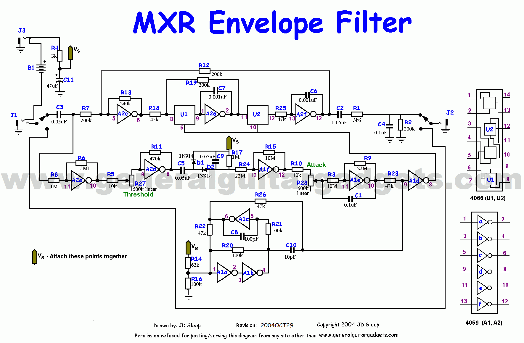

My friend asked me f I can build him a guitar pedal, and I thought it would be a nice learning experience for me.
I had some trouble understanding the use of the logic gates (NOT gate) and the electrical switch.
The usage for audio data with these digital switches passed in my head, that being a ASK modulation. But how in the hell you use a guitar signal on logic gates, and how would the result look?
Oh, and another thing:
Would J1 be the input from the guitar to the pedal, what is the J3 input is made for?
Any way, here is the circuit:
